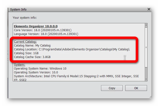

    In any event, it is possible to convert your most up-to-date 2019 catalog again so that all of your data remains intact.  Do you still have 2019 installed on your machine?  If so, launch Elements 2019 and open the catalog you want to convert and use in 2020 and go to the Help>System Info screen. (It may take a while to load.) This will tell  you the name and location of your catalog:
    Make a note of this information.

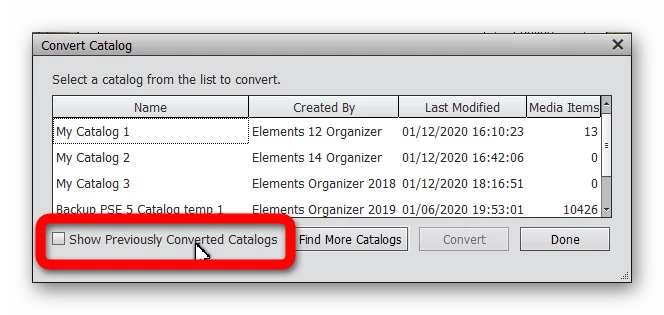

    Next, you will close 2019 and launch Elements Organizer 2020.  Go to File>Manage Catalogs and click the Convert button.  See if your 2019 catalog is listed.  If it was converted previously, it may not appear unless you click the show Previously Converted Catalogs box.
    If you still can't find the catalog, click the Find More Catalogs box.  This will open up a browse dialog and you should navigate to the location indicated for your 2019 catalog.  Once you have found it, select it in the dialog and click the Convert button.
