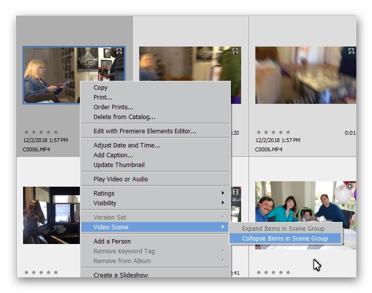

Please post a screenshot of what you are seeing. If you have file names displayed, each scene should have the same file name.

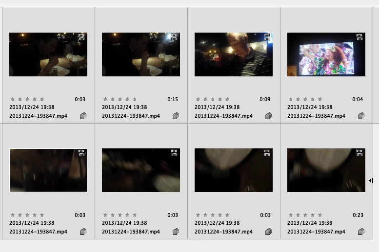

As you can see here, the first date stamp is correct as 2-12-2017 at 2:44am but the second shows 10-14-2017 at 2:08pm.  As you can see their file names are the same as they should be only one file as they are in my finder window. They just show as 2 files in Organizer.

The videos are divided into scenes when certain video analysis is performed in PRE.  If you expand the scenes, you can delete the unwanted ones, leaving only the original video displayed in the Organzier.  The scenes should not have different time stamps than the original.  Are you seeing something diffierent?

Hi there, thank you for your response. It appears that the video files are actually split up into individual files although they are still connected in some way. Each clip can be played separately and the separate files are showing different times stamps from the ’top’ file.

Also, when I try to collape the video files into a group that option is grayed out.
