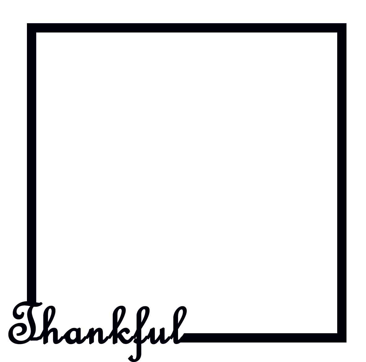

How do I create something like this?
  • October 24, 2017
  • 449 views
They are examples of PNG overlays to be placed over photographs. I think this should be fairly simple to do in PSE, and I did try a tutorial I found, but it was an epic fail. Can anyone tell me if there is a quick and easy way to do it? Also, I would like to know how to change the color from black to white.
    Welcoming any and all help. Thank you!

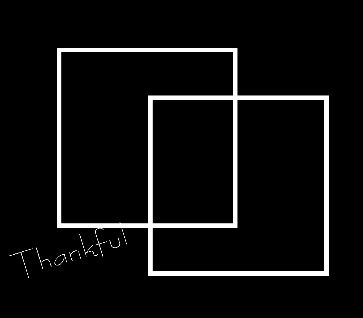

Correct answer hatstead
White frame on white background will not show up, so I used black background for demonstration.
  1. File>New>Blank file
  2. Set foreground color chip to black (or any color)
  3. Activate Paint-bucket tool and click in the work-space to make it black
  4. Activate the Rectangular marquee tool. On the tool's option bar select "fixed size" and enter the dimensions for the frame (I used 3x3"). Click to establish the outline. Then, go to Edit>Stroke(outline) selection. Place the stroke inside, width 5 px, color white. OK it. Press CTRL+D to get rid of the marching ants.
  5. Open a blank layer above the background layer (Layer 1). Repeat step #4.
  6. Activate the Move tool and position the 2nd frame
  7. Activate the Type tool and type the text. Position text by dragging or using move tool.

hatsteadCorrect answer
October 24, 2017
October 24, 2017
Thanks for replying, hatstead. That is a cool design and thanks for explaining.
However, it's not exactly what I'm looking for, and I'm afraid I should have been more clear in my original post.
I am looking for just one frame/overlay, not two overlapping ones. I wanted it to be a PNG file and be able to change the color of the PNG. Also, is there a way to get the letters of my chosen words and fonts to overlap the frame as shown in the illustration?
So sorry--sometimes I am not the best communicator!
Thank you so much.
