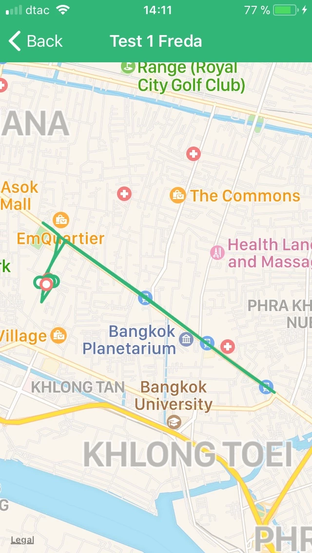

    I have been using Adobe Elements 13 for the last 2-3 years. Since my camera does not have GPS built in, I have spent a fair amount of time geotagging my photos. With the hope of simplifying the geotagging process, I purchased Geotag Photos Pro app for my iPhone 5s yesterday. When I took the app for a 'test drive', the map in the Geotag Photos Pro app tracked my short trip (a short walk and a ride on the skytrain in Bangkok) more or less perfectly (except the indoor part, which would be as expected with GPS technology). The map in the Geotag Photos Pro app is shown below:

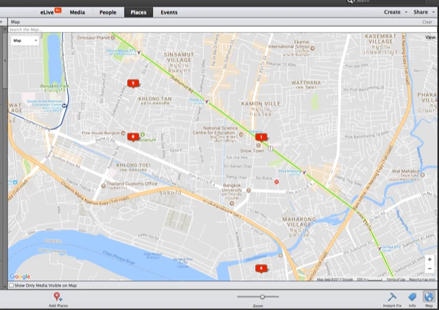

    Therefore, I expected that all my geotagging process would be solved (and more or less automated). To my great surprise, when I uploaded the pictures into Elements Organizer 13 on my iMac, the pins were all over the place. I used the default settings in Geotag Photos Pro (logging interval 2 minutes and minimal positional change 50m). Therefore, I did not expect pinpoint accuracy, but some of the pins in the Organizer map were 1-2km off the mark. As Michael also mentioned, many of the photos were grouped together in clusters (way off the mark). The way the photos were clustered was also a bit bizarre, as some of the pictures were not even placed in the nearest cluster. See map below for details. The GPS coordinates in the metadata were different for each picture, so the GPS data does not seem to have been corrupted when imported into Elements (at least rounded down to fewer decimals, which according to some users seems to have been an issue when metadata have been saved to the files).

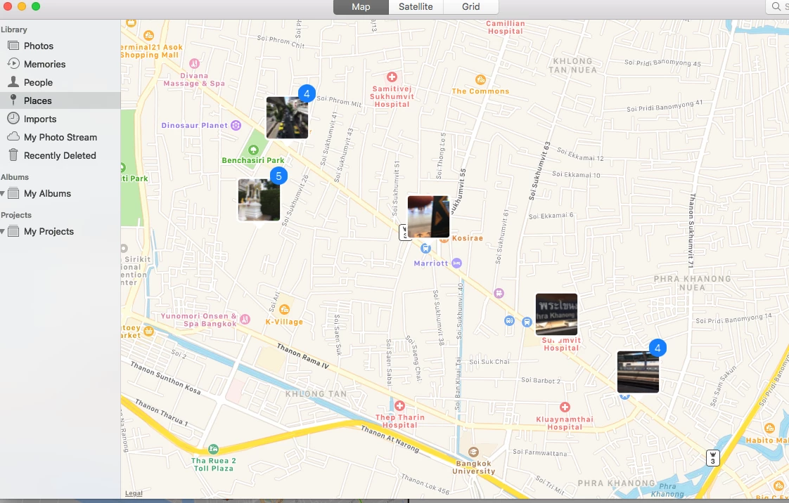

    Since I am currently also using Adobe Elements 2018 during my 30 days free trial, I also imported the pictures into Elements 2018. But the result was exactly the same as for Elements 13. Then I imported the pictures into Apple Photos. And the geotagging was remarkable accurate. See below.
    Therefore, it seems like both Geotag Photos Pro and Apple Photos (at least the geotagging) are working remarkably well. And the geotagging inaccuracy problem is somehow caused by Adobe Elements, but I do not really understand how.
    Since both Elements 13 are Elements 2018 are displaying the same mapping inaccuracies, I would guess that  the Elements version in between also would display the same incorrect locations. I would be surprised if an error like this would have been persisting for so many years (but I could of course be wrong...). The problem may therefore be related to the 'interaction' between Elements and Google Maps.
    Now I faced with the following dilemma: Do I leave the pins at the incorrect location (with presumably correct GPS coordinates), or do I move the pins to the correct location on the map (which presumably will render the GPS coordinates incorrect). If choose the former, it will be annoying to look at the incorrect locations on the map. If I do the latter, I risk that all the pins will be incorrect in the event Adobe fixes the problem or I start using a different program (e.g. Apple Photos).
