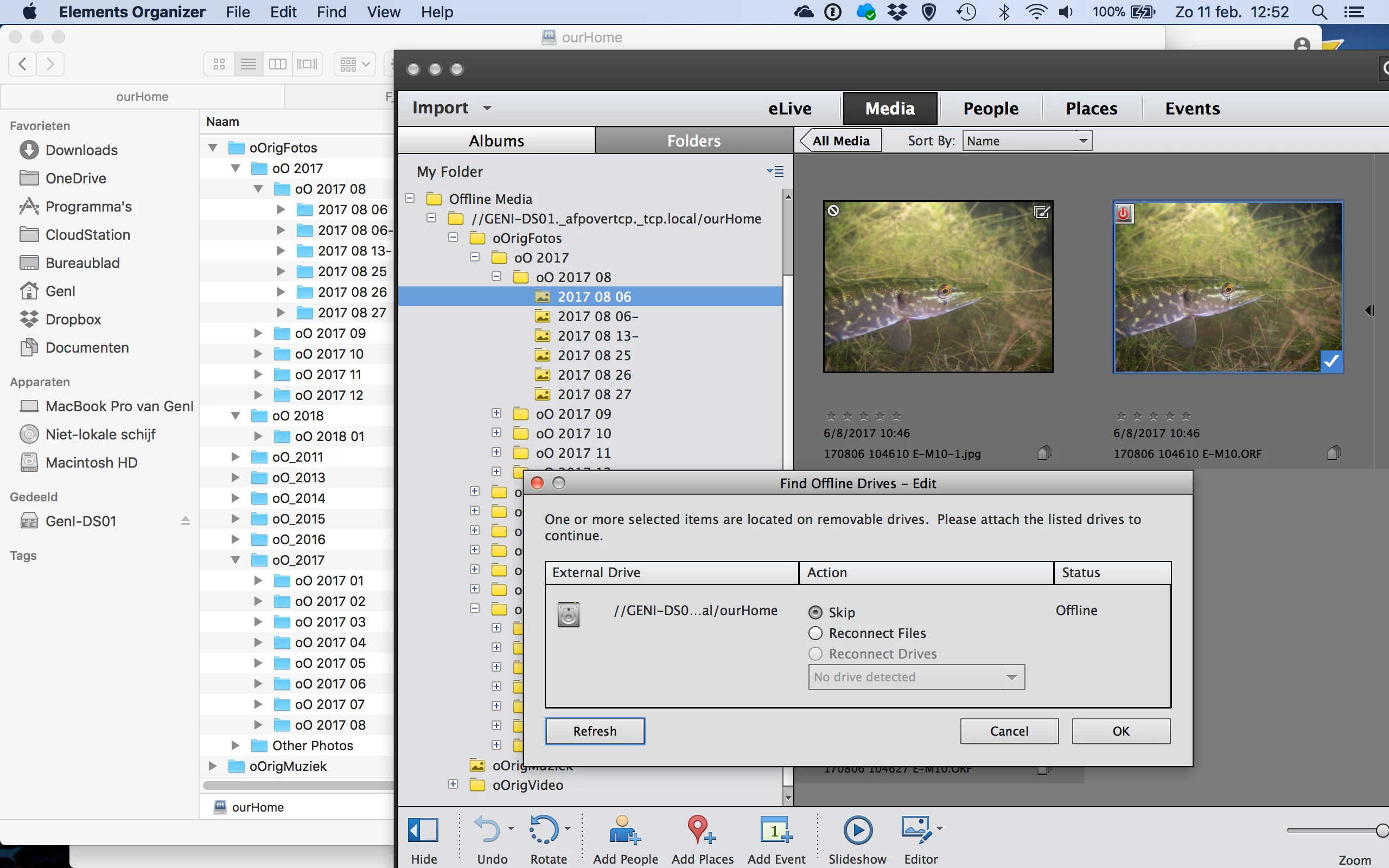

When selecting one Offline RAW file and open PSE Photo Editor, the popup appears to reconnect.(see included screenprint)
Strangely, the reconnect drive option is grayed out (while being connected), but the reconnect picture allows me to reconnect the individual picture.
A new entry in the folder structure appears for the NAS, with only the folder structure for this individually reconnected RAW file AND - importantly - the version set remains in tact. In the offline branch, the offline version is removed, preventing duplicate entries. Perfect solution for one image.

    How to identify: In the "Find Offline Drives" pop-up, give a bit more room to show the required networkpath. In case of an "afp:" connection, you will see the letter 'afp'. Even before, you can see it in the folder structure, where the offline drive name contains '_afpovertcp' (afp over TCP). You can see it in the screenprint I added with my question.
