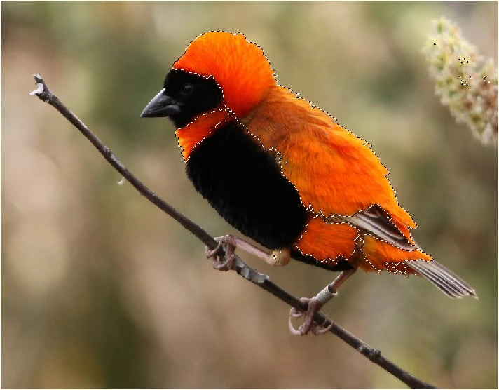

    I found this Red Bishop on Google images.
    I selected the orange using the Magic Wand with a Tolerance of 150 and the Contiguous option unchecked. I clicked on the bird's head to get this selection:
    It didn't quite select all the orange so I used the Lasso tool to select the rest:
    Then added a Hue/Saturation adjustment layer and moved the Hue slider to -18.
    Note that you will might have to try different Tolerance values and/or click on different parts of orange to select as much orange as possible, and then use the Lasso or other selection tool to add or subtract from the selection.
