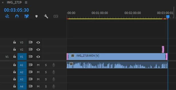

Hi there,
I don't know if anyone else is having this issue.  But since updating to Premiere Pro 22.3.1, my export to MP4 has been greatly out of sync.  A particular video of mine on the time 3 minute, 5 seconds long, in the program, but then when I go to export, the video increases dramatically to 6 minutes 10 seconds... it's as if the video gets stretched out and the audio remains the same... increasing the offset sync dramatically by the end of the video.  I don't know exactly how to fix this.  I've export to MOV, and it works fine.  The video and audio are in-sync.  But MP4, it gets wonky.
Any ideas?
Thanks!

Check your sequence properties and also your timeline, make sure it is of the length you are expecting. Make sure the frame rates are the same. First I was thinking it was variable frame rate footage, (like typically from a phone or screen capture) which PP doesn't handle well. But being exactly double? That sounds like some setting is off.

When I export to Quicktime MOV the final file is perfect.  The length of the video is what is stated on the timeline in Premiere Pro.  When I export to MP4 instead, so that I have a smaller final file size, the length of the exported video stretches, doesn't make sense.  So, the export to MOV works... the export to MP4 does not.  It's weird that exporting to one file type would work and the other wouldn't... and there isn't any change in the editing of the video within Premiere Pro.  Yes, I did capture the video with my phone, but until I updated to the latest version, I never had a problem.  😞
I'm probably not saying any of this correctly... please refer to images.  You'll notice that the file type for the MP4 is 940 MB +/- yet the length is time stamped at 6:10, and the file size for the MOV is 9.8 GB and time stamped for 3:05.
Any ideas?
