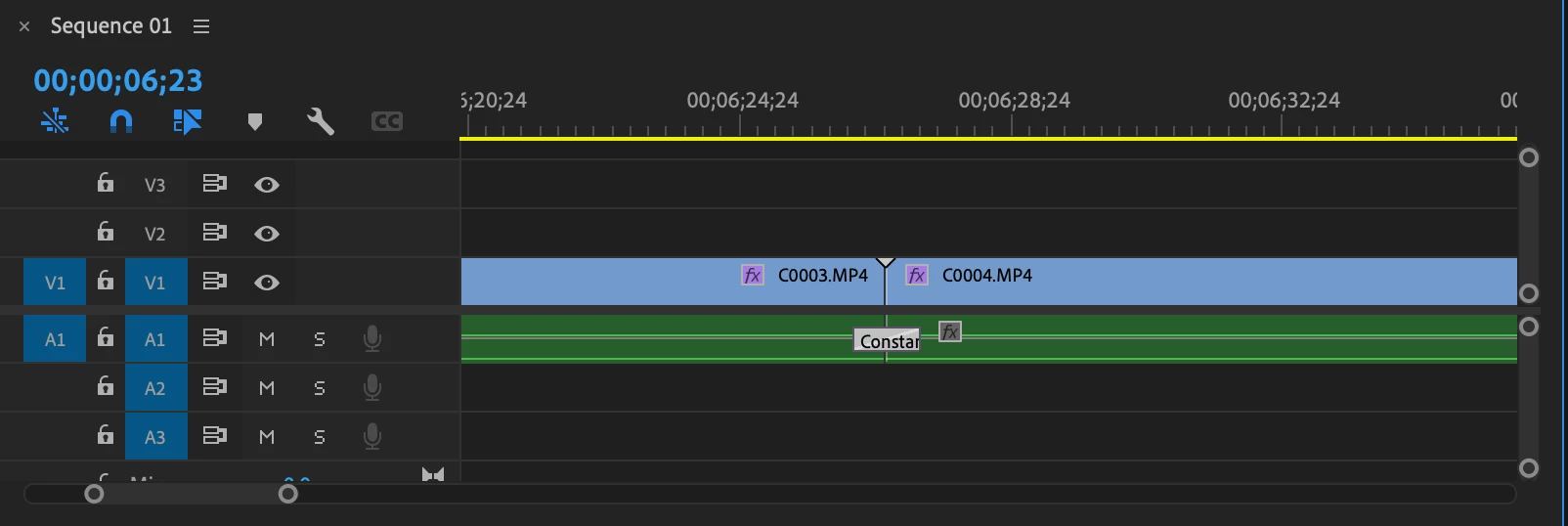

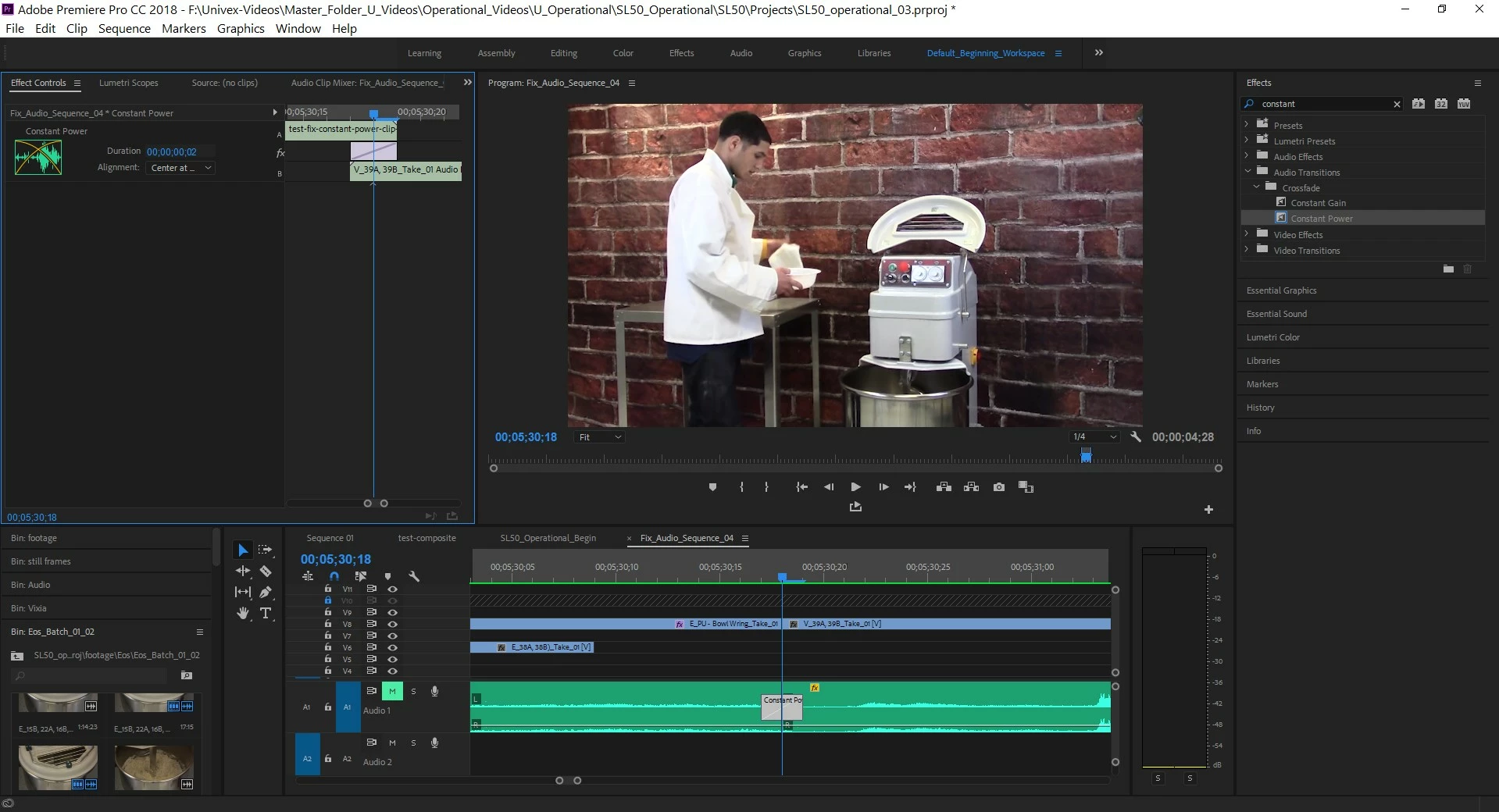

I cannot apply the "constant power" transition between two specific clips Adobe CC 2018.
"Show Audio Time Units" is not toggled on, and as far as I can determine there is no gap between the clips (see screenshot).
Neither can constant power be dragged to straddle the clips using the effects controls, nor is there any option in the effects controls panel to center constant power at the cut when constant power is highlighted - the option is grayed out (see screenshot).
"Constant Power" can be dragged onto each clip individually, which as I understand means the problem is not the length of the clips.
Is there something simple I am missing, or is this a bug?!
Please help! I'm at a loss, and I really need to finish this project.
Correct answer Wes Howell
I believe this may be happening because you do not have enough handles / trimmed area in your clips.
As a test, can you trim the clips more, line them up and see if the transition will then work?

May 23, 2018
Well, I'll be darned, it was the handles - thanks. I trimmed both clips up by exactly one frame on the adjoining ends and it worked (see screenshot).
This, however, makes my match cut a bit off. Is there any way to fix this problem and keep the same cut point in my clips?

May 21, 2018
Are you sure about that? I can't drag Constant Power between two clips that have no extra frames (handles), but I can drag it to each even though there are no extra frames.

May 21, 2018
Thank you, but I am aware that two transitions are applied. I specifically applied one "constant power" transition to each clip to demonstrate that it could be done in the screenshot.
Again, a single "constant power" transition CANNOT BE APPLIED between these two clips.
