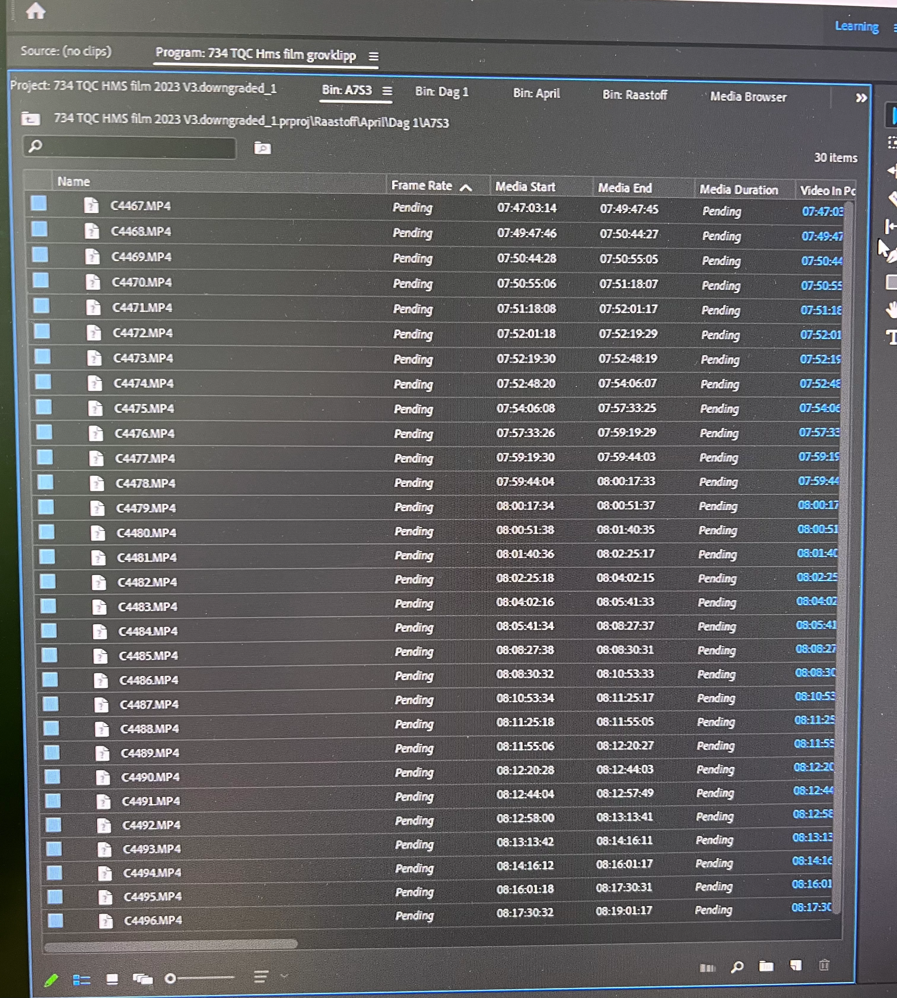

Hi, I have a problem with all my clips showing up as "pending" INSIDE the project bin when opening up the project (see the attached image). Then after quite while, they slowly shows up as normal one by one. When all the clips have appeared, the timeline is slow, laggy and does often freeze.

Make new project and import this one: see how that goes.
