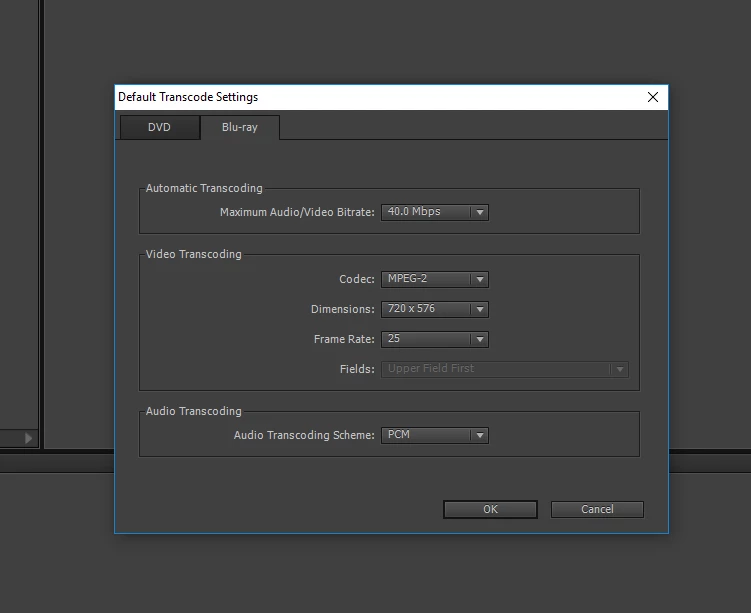

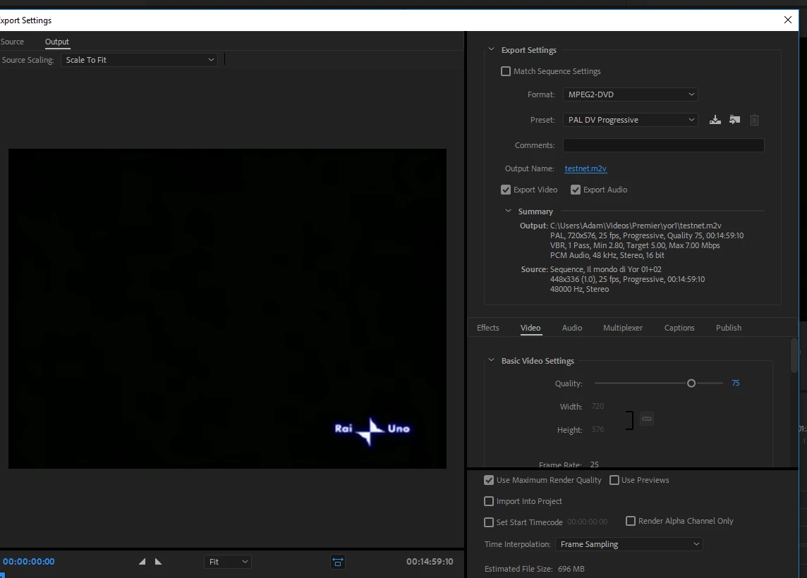

Thanks for your message. I have done everything and once imported into encore I get the following:
DVD Transcode Status = video don't transcode audio untranscoded
DVD Transcode Settings = video don't transcode audio automatic
Blu Ray Transcode Status = video untranscoded audio don't transcode
Blu  Ray Transcode Settings = video automatic audio don't transcode
I've attached the report from mediainfo and screenshots of my various settings.
Cheers

Also just as a test I have changed premiere to output as upper field first, which is what encore seems to want on the default settings. The outcome is don't transcode for everything except dvd audio.
So that seems to solve it, I guess the question is what are the downsides of changing the footage from progressive to upper field first? If any?
Also could you elaborate a little on the quality 100% not being the best? I just assumed if I set this as 100% and cracked the bitrate up to the maximum I would get the best result.
