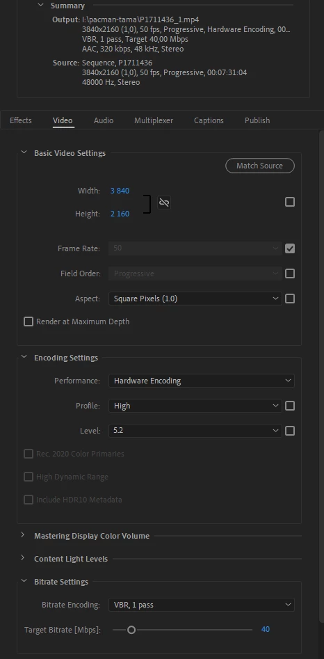

    If I'm not mistaken, with 14.2 installed and a 2080, you would no longer be using Intel QuickSync but instead you'd be using NVENC for Hardware Encoding. I honestly don't think it's possible to select between the two even if you have a machine that is eligible for both. I don't have a CPU that suppoorts Intel QuickSync encode though so I couldn't tell you. Kevin would likely need to validate this, I'm just taking a guess... but I didn't read anything about being able to switch between hardware encode methods for what its worth.
    That said as Kevin brought up, your GPU-based render might have certain or different limitations with export settings that your CPU-based render might not of had. What are the rest of your export settings? For example, I recall reading something like GPU encoding is not able to do 2-pass VBR, so if you set it to 1-pass instead it should allow Hardware Encoding to be available again.
    So yeah at face value I don't think it's so much an issue with 14.2 breaking QuickSync, as it is 14.2 is saying "hey you have an eligible Nvidia GPU, let's use that instead" and NVIDIA GPU based hardware encoding (NVENC) has a different rulset than Intel CPU based hardware encoding (QuickSync).

    You're right, but you missed the part of my post regarding specific criteria GPU acceleration encodes have.
    Yes, with Hardware Encoding greyed out and not selected, you are using Software Rendering. Not QuickSync, Not NVENC. No doubt about that.
    That said my point was that depending on the rest of your encoding settings, GPU Hardware Encoding might not be eligible to use (whereas previously it was still ok with CPU Hardware Encode)

    May 19, 2020
    Arkadias,
    Did you toy with the Profile and/or Level settings at all? Things like that can void the Hardware Decoding feature. Let us know.

    Thanks, Kevin. I am trying the same file with the same preset in both versions of Premiere.
    In 14.1 the Hardware Encoding option is available, in 14.2 it is greyed out with a message saying that no compatible hardware was found.
    The settings are as follow. The only difference is that 14.2 does not allow me to choose "Performance: Hardware Encoding" in the Encoding Settings anymore.
