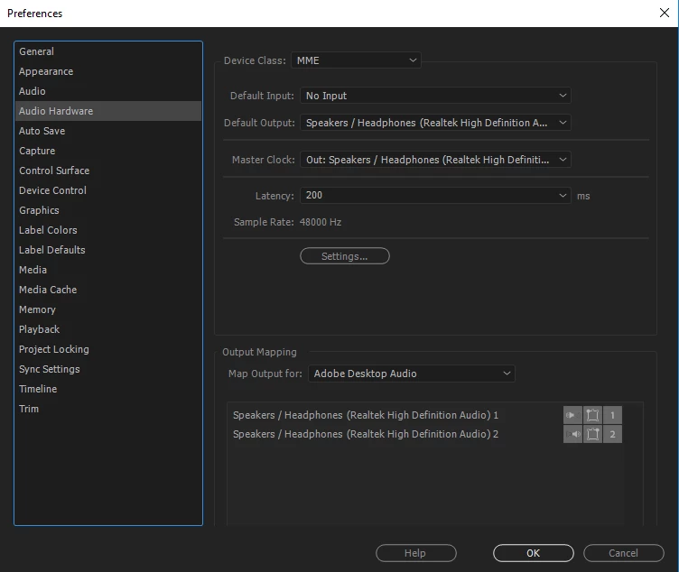

Hey guys,
Been having this issue on a specific workstation at my work, and it's been causing issues with mastering. I already did some digging, and the closest forum post I could find is this one, but it's not quite the same thing, and was never solved.
Essentially what's happening is Premiere will jack the audio on my computer way up when playing clips or sequences. When I go to change the system volume, Premiere gets changed drastically. For example, my system will be at 30 and Premiere will be painfully loud. I'll change it to 25, and Premiere will be much quieter. Even after I change it back to 30, all audio is significantly more quiet than it was originally, meaning (I assume) that Premiere is actually following system volume now.
I'm not quite sure what triggers this override of system volume, but it seems to happen when I open a new clip or sequence, and sometimes during editing a sequence. It's a simple matter of dropping the master volume while editing until export, but there's no way to do the same thing universally when sorting through raw footage.
This issue means I can't reliably sound mix my sequences, and have already run into issues of the video not sounding how it should. It's a pain because this station is the only one with the problem, but it also has the newest version of Premiere, meaning I can't bring it to a working station. Any thoughts?

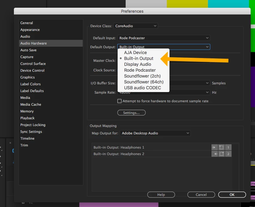

June 26, 2017
My understanding (which may be wrong) is that when you specify the direct path to the Realtek, it routes the audio directly there bypassing the system and system volume controls.
If you click on the drop down menu for Default Output, is there a system option listed there? I am Mac based and not familiar with windows, but on my Mac it shows up as a separate option:
By choosing the system as the output from Premiere, then in the OS setting the sound output from the computer to the correct destination, I've effectively routed audio: Premiere (volume control within Premiere) > System Sound (with System Sound volume control) > Destination.

June 26, 2017
I think the OS is bypassed only when using a ASIO driver, the default MME uses  Windows.
