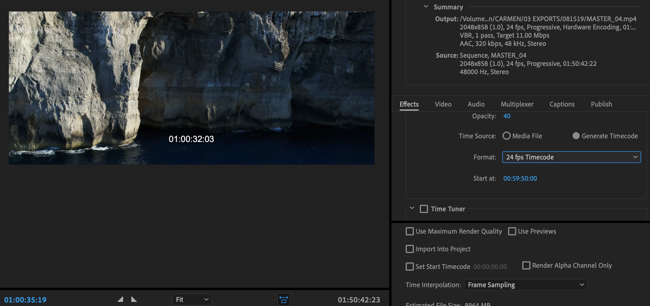

All attempts to print timecode on exports are in vain as Premiere apparently produces completely random numbers, both in the export options under "effects" to produce Timecode, as well as the Effect which I tried applying to a Transparent Layer as well as an adjustment layer.
In the Export settings, I tried generating timecode as well as using the "media" option. Neither were correct. I have indeed set it to 24fps as my project and media is. Even offsetting the timecode to begin at the same number the film starts at eventually has the generated TC drifting. It doesn't make any sense to me. Here is a screenshot.

I am able to get some slightly unpredictable results when I place around with clip rate interpretation but ultimately when I "generate" timecode at 24fps on a 24fps timeline with a "start at" whihc matches my sequence then it works as expected. What are you sequence settings and are all your clips true 24fps? ie. not 23.98.

isn't there some kind of tricky 'drop frame' timecode setting if you wanna use 24fps timecode for 23.976 stuff ??? So it doesn't drift ?
