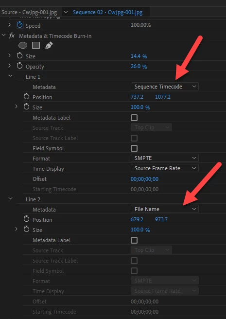

I got it to work again, but it takes a few adjustments.
It works with both AL and directly on a clip.
Here's the settings.
1) Timecode goes in Line 1
2) You have to put the Filename in "Line 2" (ie: not in Line 1)
Watch out for the Line 1 timecode, it looked like it wasn't doing anything, but then I saw a very light sliver, and there seems to be a lower limit to how you can place it, so just raising it up a bit displayed it.
I think this will help.

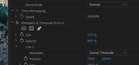

You might also check out the new(ish) Metadata & Timecode Burn-in effect.
It works on an AL, and has a bunch of options.

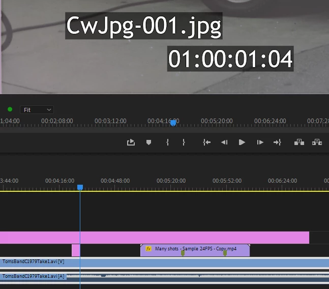

Peter A Lund
October 26, 2023
Hey,
yes works , but only for videoclips
If you make a slideshow (and need the reference of the image in the picture, like in the old days
of printing the numbers of the film outside of the Film for reference)
Its not showing up. It also does not make any other reference.
Can somebody confirm this pls?
thanxs.

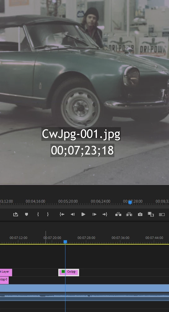

MyerPj
October 26, 2023
It does show the  file name using a jpg in the timeline.

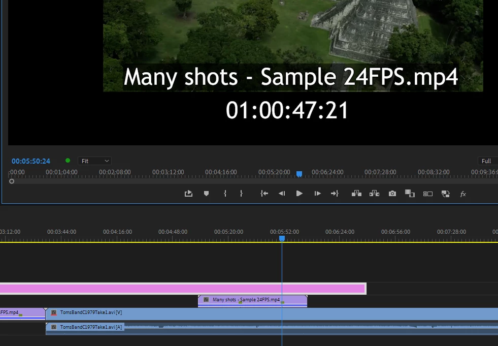

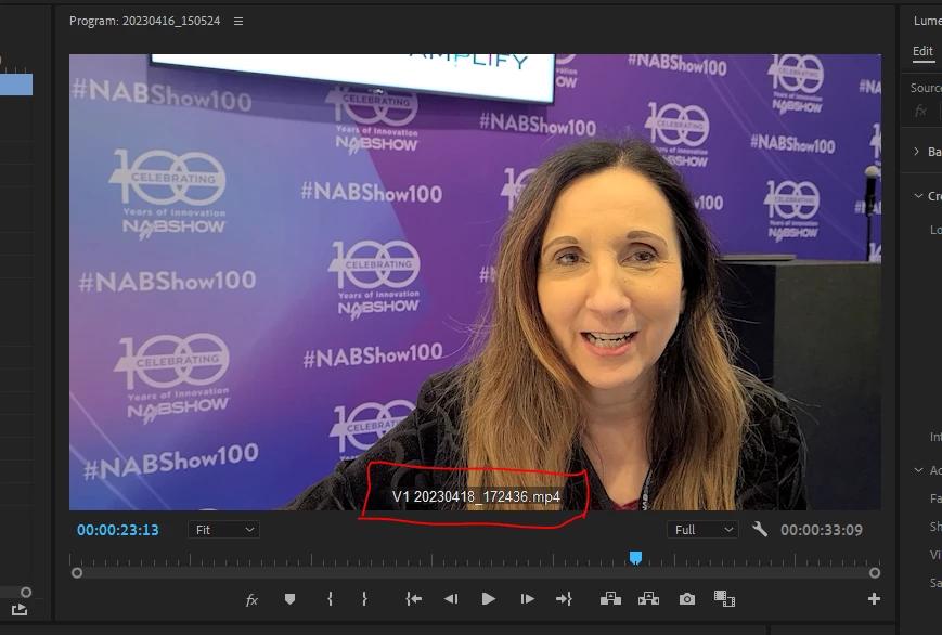

R Neil Haugen
October 25, 2023
You can do this via the Overlay settings ... as I've got here.
Options were sequence clip name, track V1, bottom centered.
Everyone's mileage always varies ...
