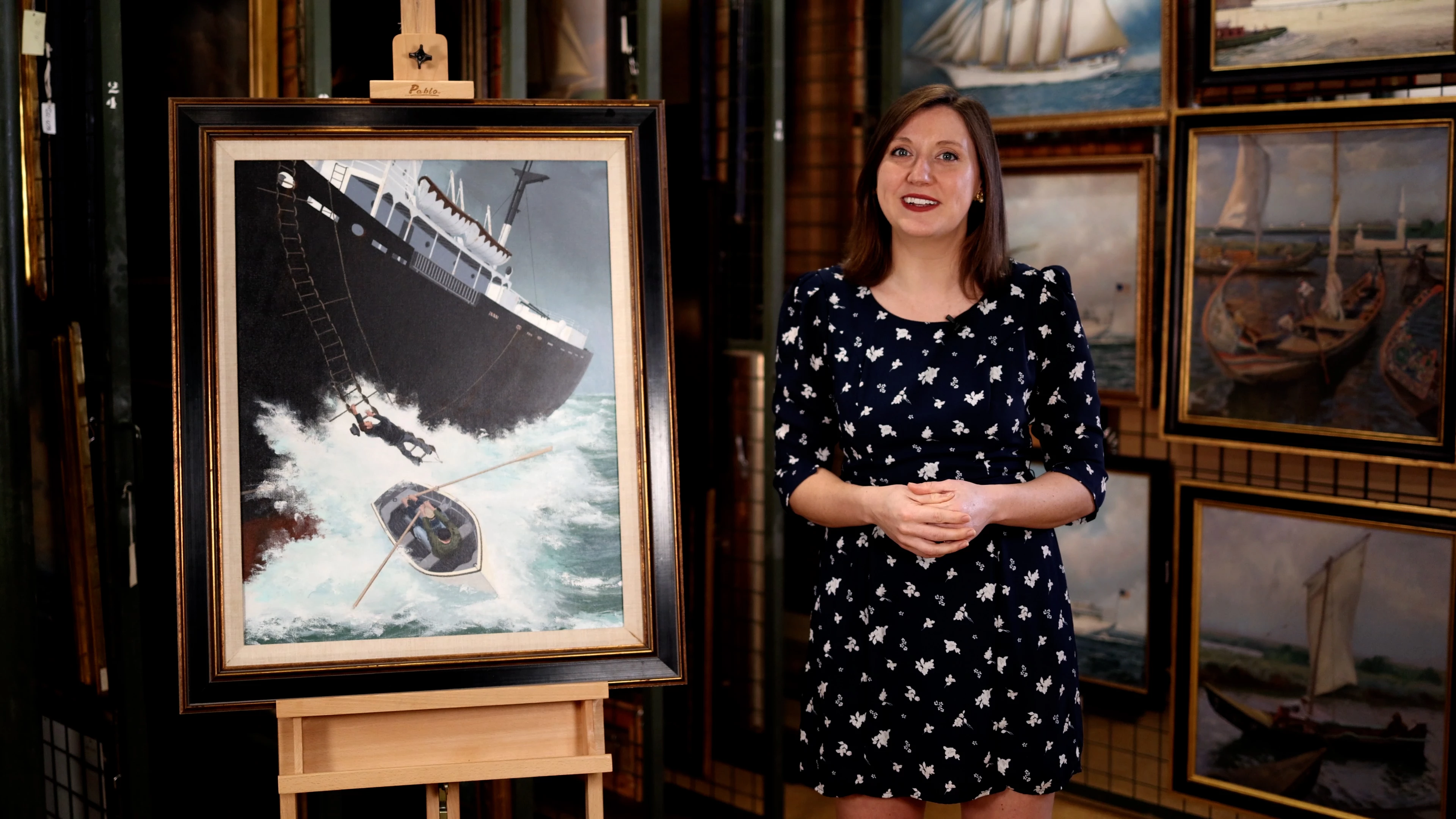

I'm having issues with getting random color shifting after exporting - it's almost like there's a few frames of an adjustment layer that will pop up for a frame and then disappear.  The first two screenshots below are consecutive frames and then the third is where it shifts back approx 7 frames later.
There is no adjustment later, no lumetri keyframes, etc and as I've been working though "fixes" and exporting, there have been more showing up in the project. Nothing shows in the timeline before the export either.

Yes, I'm trying to export the original UHD 23.98 file into a 30 fps H.264 seq with captions burned in. I'm using the optical flow time interpolation to help smooth the frame rate change. I'm getting error after error and so I'm using hardware encoding only, GPU acceleration turned off.  I was using Premiere Pro 24.2.1 but was having so many issues that I opened a copy in Beta 24.6.0 and got even worse errors - see the attached picture.
I am using warp stabilizer on some of the B-roll clips (I'm having issues with the frame rate shift with those, too), but this is really a straightforward edit and the majority of the clips where the color shifting appears are just talking head shots that are almost entirely unedited with just a slight RGB curve edit.
