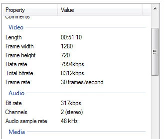

Any input is appreciated!
Properties of source video:

Since your video is only 51 minutes, I'd just go CBR 8 for the DVD, and for the Blu-ray, perhaps CBR 25? I see no need to go higher though, as the source itself is only 8mbps.

For DVD, encode as MPEG-2 DVD and use the NTSC DV Widescreen Progressive preset. Encode CBR using 8.0 rate. You can activate Max Render since source is being scaled HD to SD.
For Blu-Ray, encode as H.264 Blu-Ray using the 720p59.94 preset. Maybe 20-25mbps for data rate....the source is only 8mbps so no benefit to going too high, won't look any better in doing so.
