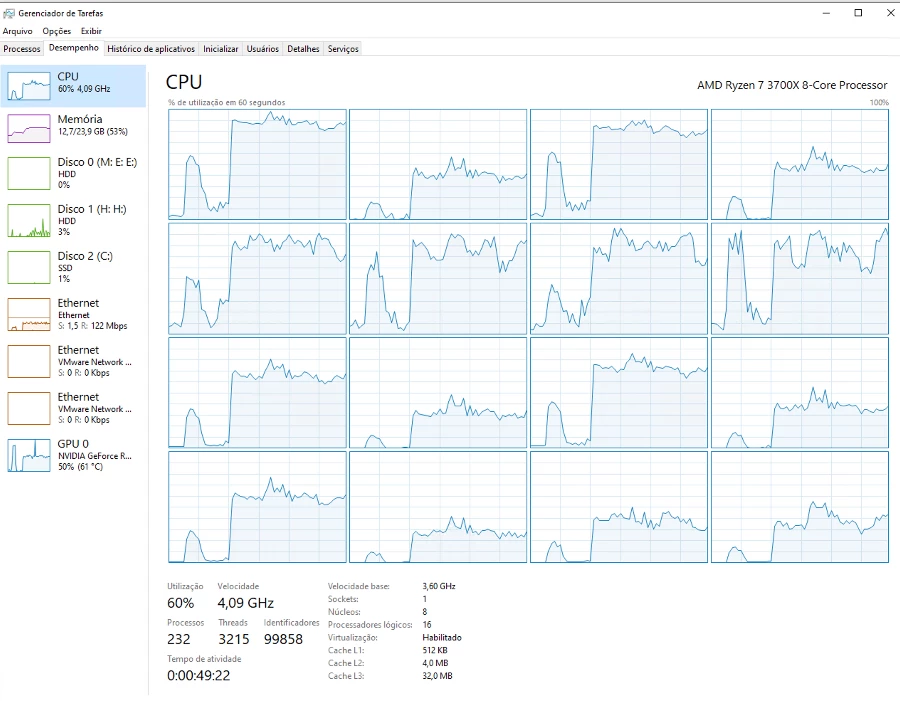

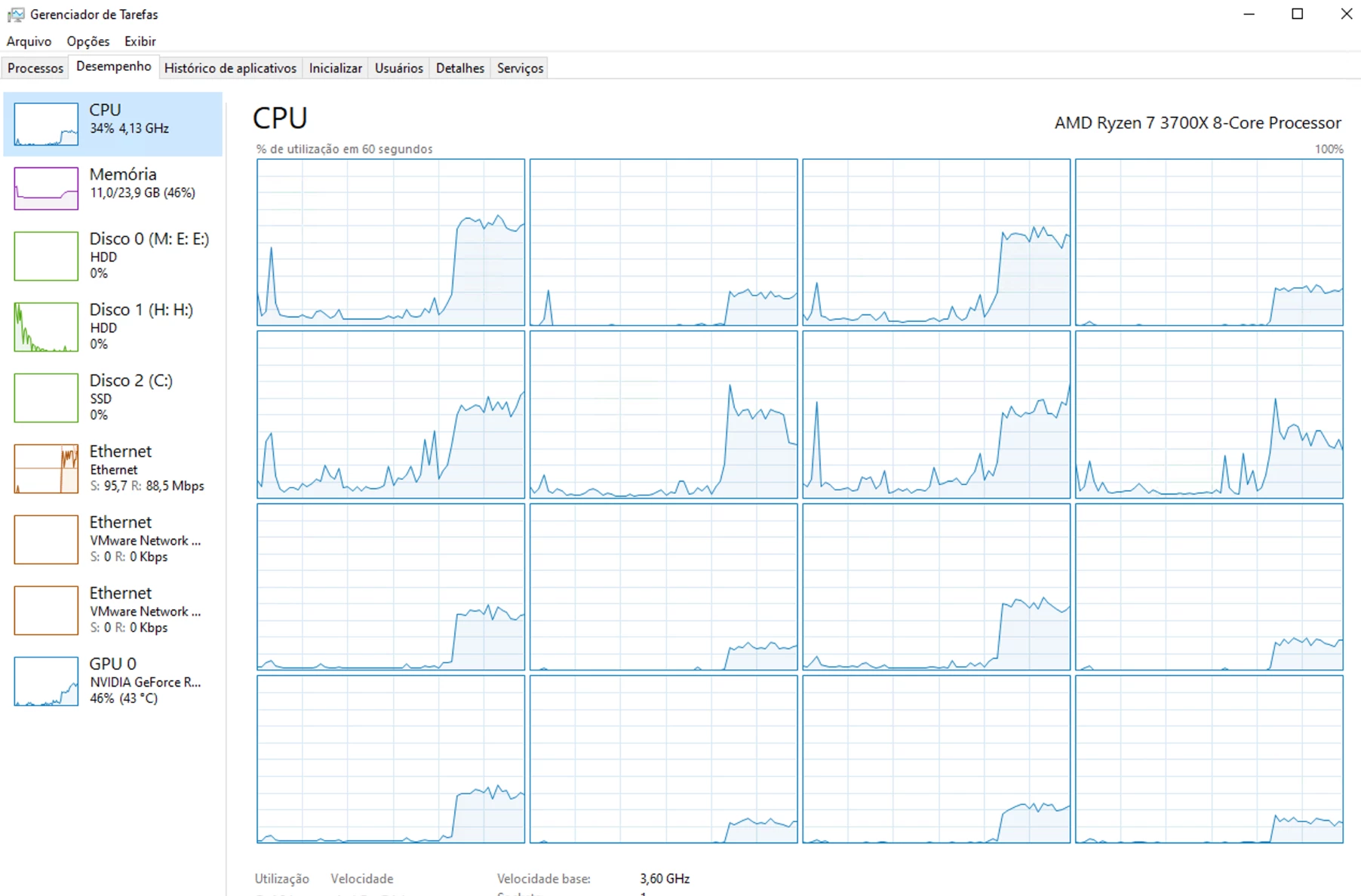

Whenever I export a video with DESTINATION on the NAS SSD, the CPU usage is 35% and GPU 40%, with a speed of 100Mbps and reading and writing (12MBps).
When I export a video using my PC's SSD, CPU usage is at 62% and GPU at 50%, exporting 2x faster than when saved on the NAS.

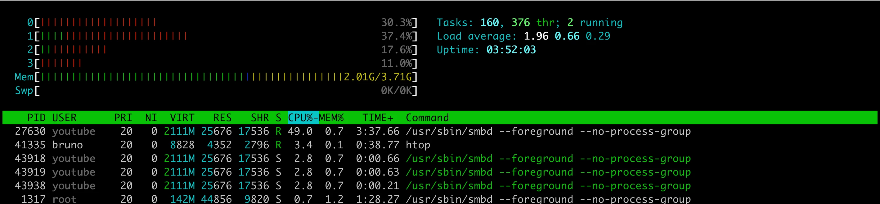

Can you monitor the Raspberry Pi CPU usage during your exports? If the CPU and/or RAM usage of the Pi is very high then that is your culprit – it takes CPU power to handle more network loads and the Pi is the limiting factor.

@mattchristensen thanks for answering, think about it too, I ran the export and saw that the CPU usage is below 30%:

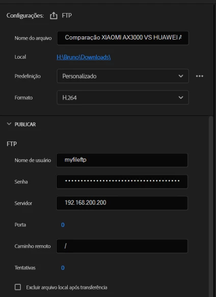

Interestingly, when testing with an Notebook I5 (9400H) with NVME SSD sharing a folder, I had the same performance as my Raspberry Pi 4 NAS. It's as if Adobe Premiere doesn't handle shared folders very well on Windows. I tried to test using FTP Upload, but I can't configure the FTP port to 21, it only remains 0, even though I try to enter the value:
