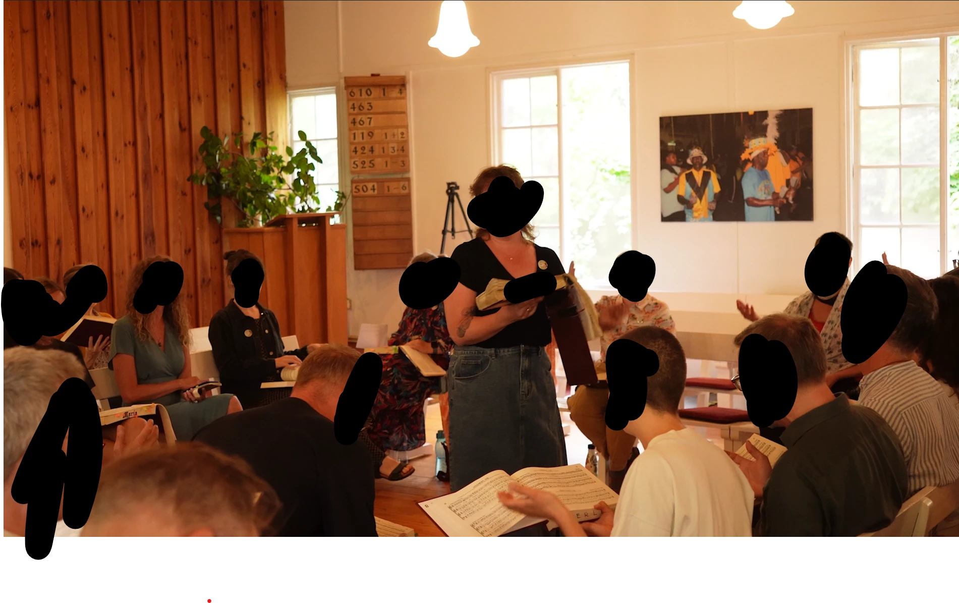

Hi! Super-beginner 'videographer' here.
I'm new to this but I am an artist, so I'm not a stranger to color in general.
I've shot a bunch of footage that I'm now editing, and I'm struggling with color correcting it.
The camera white balance was set to daylight, but I was shooting indoors.
There are very bright windows (daylight) in most of the footage.
I'm wondering which of these three aproaches would be better for correcting:
(all in Lumetri)
1) Adjusting Temperature/Tint
2) adjusting the saturation of specific hue ranges (ie: bringing down red-yellow).
3) use color wheels to shift shadows/mids/highlights separately?
I've been trying out combinations of these three and can't quite land on something that looks natuarlistic. Mostly the problem is how oversaturated the orange looks, but I can't seem to strike a balance between reducing the orange hue without reducing the overall picture quality.
Shot on a ZV e10 with auto exposure settings and no picture profile (but fixed on daylight white balance).
Thanks

Thanks Neil for the in depth response! I think something that was throwing me off a lot was the exposure. I think that the bulk of the image (everywhere that wasn't window), was quite dark. So starting with changing the brightness of the footage seems to make the rest a lot easier. I haven't had more than a few minutes to play with this today, but so far I'm having more success first increasing the exposure by 0.5-1, than I am with going straight to either black and white points or straight to the color wheel shadows, midtones, highlights options.
I will try more of your tips tomorrow when I have more time to work with this footage.

Temperature and Tint should do most of the heavy lifting to reduce the overly warm interior. Then if the outside becomes very cool, I would hue shift the highlights using the Color Wheels but if that is to broad an adjustment I would use a HSL Secondary adjustment and play with the settings using a fairly heavy blur. Make sure to check the box next to the 'White/Black' dropdown so you can easyily see what will be affected.
Don't overthink it - there is no such thing as a perfect image. Toggle off your correction, if its better than before then you've made an improvement - don't chase perfection.
