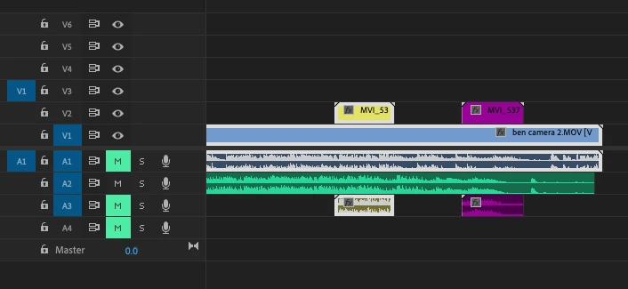

Hello, community! I could really use a hand understanding how to fix an issue I'm having. So far, I've had no problem using Premiere to sync video clips using audio using the following process: *select both clips, right click, select "syncronize", and make sure the correct audio track is selected.
Right now, I'm working on a project that's a bit more complicated and am running into problems. When I try to sync new video clips, the clips that are already perfectly synced get bumped out of place. I don't know what features, etc to start with.
The story:
I'm editing a music video that has multiple camera tracks and one mixed audio track. I'll explain the issue as best I can using a screenshot, but let me know if there's other info that would be good to include. Will describe the content of the tracks after the screenshot. (will also attach the image file)
V1 and A1 are from the main camera that was on a tripod for the whole song. They are the backbone I'm building the video around.
A2 is a professionally mixed version of the audio from the performance. I had microphones infront of the instruments during the song. I plan to mute all camera audio and just use this track for the audio in final mixdown. I was able to sync the audio from A1 and A2 with no problem, and I'd like to keep these locked together.
The purple clip is a short segment that was filmed by a videographer during the song. No issues using the audio from the purple clip to sync with A1 (the audio from the tripod camera). I know that it would have been better if the videographer let the camera run the whole time so it wouldn't be necessary to sync a bunch of clips.

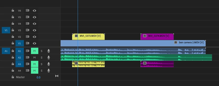

NOW, the yellow clip is where I start to have issues. When I added it to the sequence and used my usual process to sync it to the A1 audio, the two main audio tracks got bumped out of alignment. So... The Yellow clip and A1 are now in alignment, but A2 (professional audio) is no longer aligned with A1 (tripod camera audio). So now, I have this result:
I spent some time messing around and doing things in a different order to see if I could get past the issue, and no luck. I'm just not sure of the next thing to try.
If anybody have experience getting something like this to work, I'd be extremelly grateful to hear your thoughts!
Correct answer Ali Jaber
I don't have time to test different synchronizing options, but you may find this workaround to be useful:
I would use clip markers to resynch the audio: select A1 and A2 press M to create a marker on each clip. Now whenever those clips are shifted in time, I will align both clips together using created markers as a visual aid for me.
Ali JaberCommunity ExpertCorrect answer
November 4, 2020
November 4, 2020
Great idea! That was an option I didn't know about. I'll give that a shot this afternoon and see if it helps. I appreciate your input.
