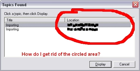

How do I get rid of the "Location" shown in Topics found dialog box?? Anybody?
Thank you,

    Yes, my solution was for the "Location" column in the full text search results listing.  Your picture looks like the popup window that is displayed from the Index tab.  I don't know of any way to switch off that "Location" field, sorry.

    The solution is in:
    File => Project Settings => Uncheck Binary Index. The problem with that solution is that instead of showing the topic title in the "Topics found dialog box" it shows something like:
    Topics found
    Title:
    1_Chaptername.htm#Topicreference
    D_Chaptername.htm
    It should say:
    Topicreference
    D Chaptername
    Any ideas how to achieve that result?
