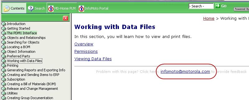

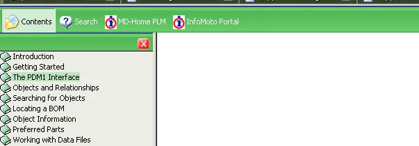

In all three examples above, when I click on an email link, the main page of the KB goes blank, and nothing happens.

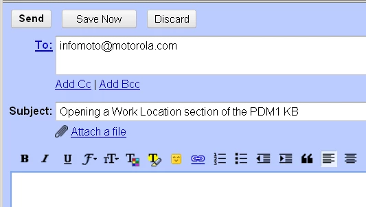

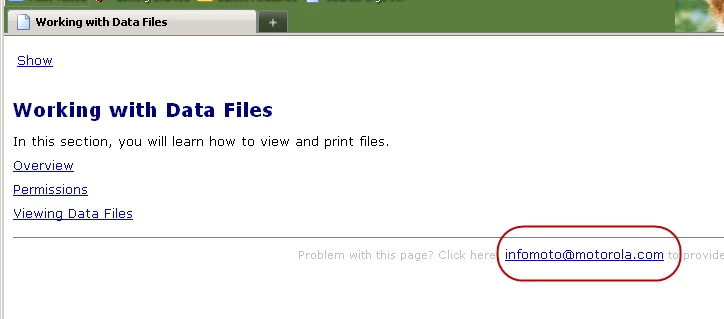

    Some additional information - did some more testing. If the page uses the contents, as this one does, the email does not work. Again, it did with Outlook, but it does not when the user uses google mail as their email client. Desperately hoping someone has a solution...
    However, if I were to open this in it's own window, without the contents frame, the email works perfectly, and launches a gmail window -
