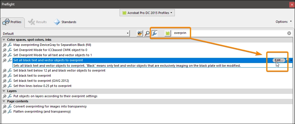

You must edit, or duplicate, the fixup.
A picture is worth 1000 words:
JR Boulay
JR BoulayCommunity ExpertCorrect answer
February 22, 2024

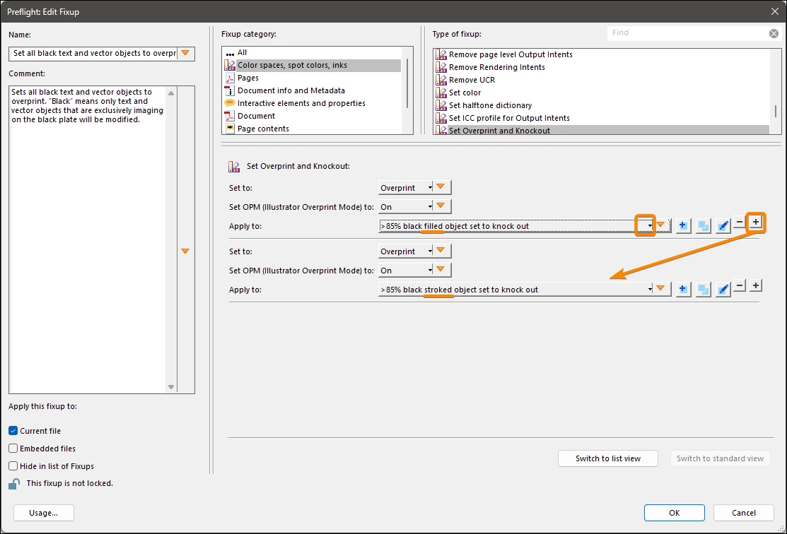

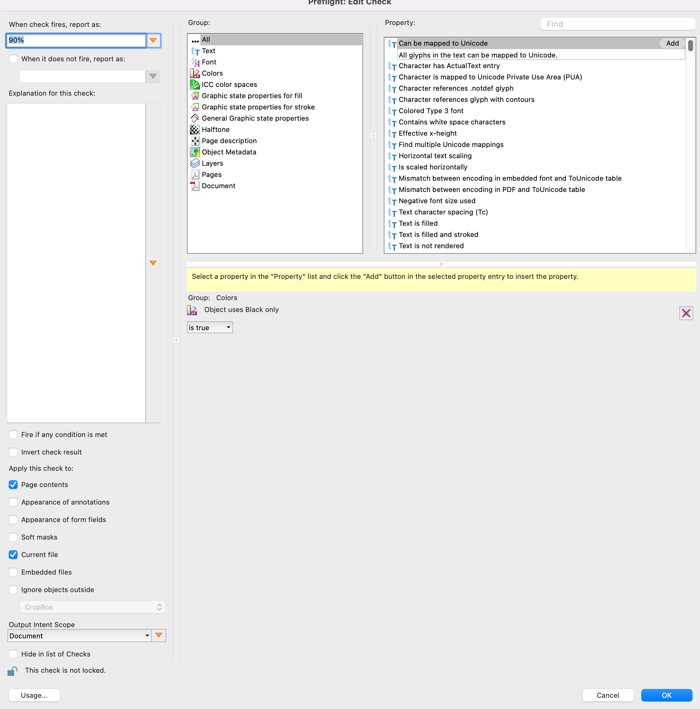

What settings did you use to create the new apply to? I tried with this.
February 22, 2024
Just found that setting in a different sub group of the fixes... i'm sure they used to be all together.
Thanks for pointing me at it
