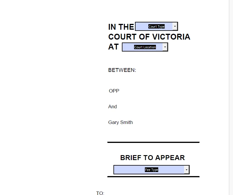

Hi, I am trying to create a form with 3 drop downs.
The first drop down is "Court Type" - Magistrates, County etc
The second is "Court location" - Melbourne, Geelong etc
The 3rd is 'Fee Type' - Magistrates - Bail $456, Plea $880, County Bail $880, Plea $1200
What I would like is if the court type is selected, the relevant court location appears in the drop down (I have got this script right)
But then I would like the relevant fee type to appear in the 'fee type' drop down. I cannot work it out....
HELP!!!

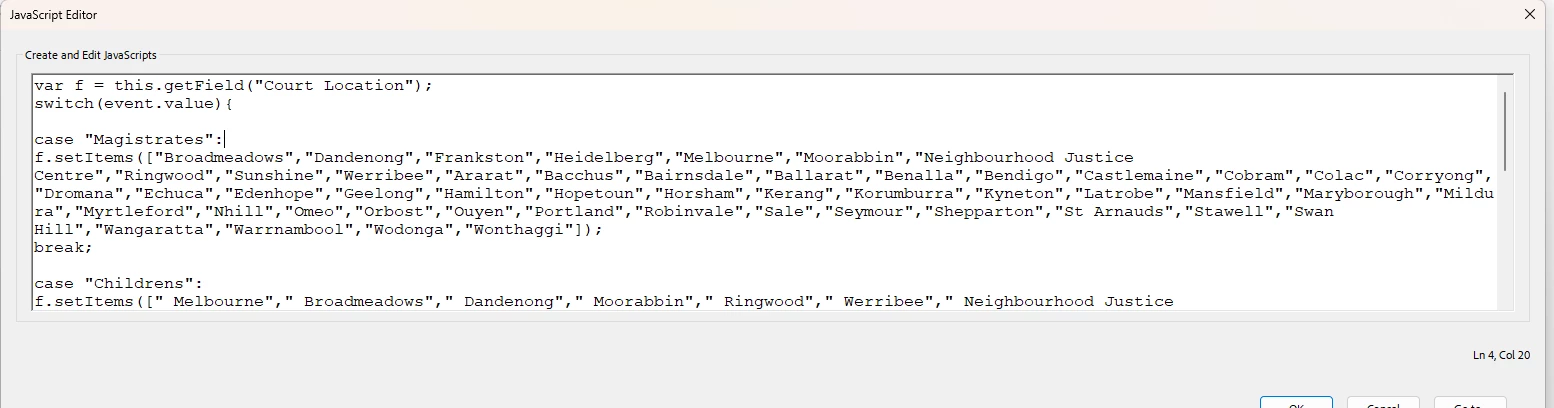

Its still not working, If I do put that script in the Court Location box, there is no drop down option in the fee type, it's blank. Could it have something to do with the fee type drop down and the court location drop down both being reliant on the selected option from court type? The fee type drop down is not reliant on the court location and vise versa
Nesa Nurani
October 27, 2024
Post the script you tried to use in "Court Location" (not photo of the script)
