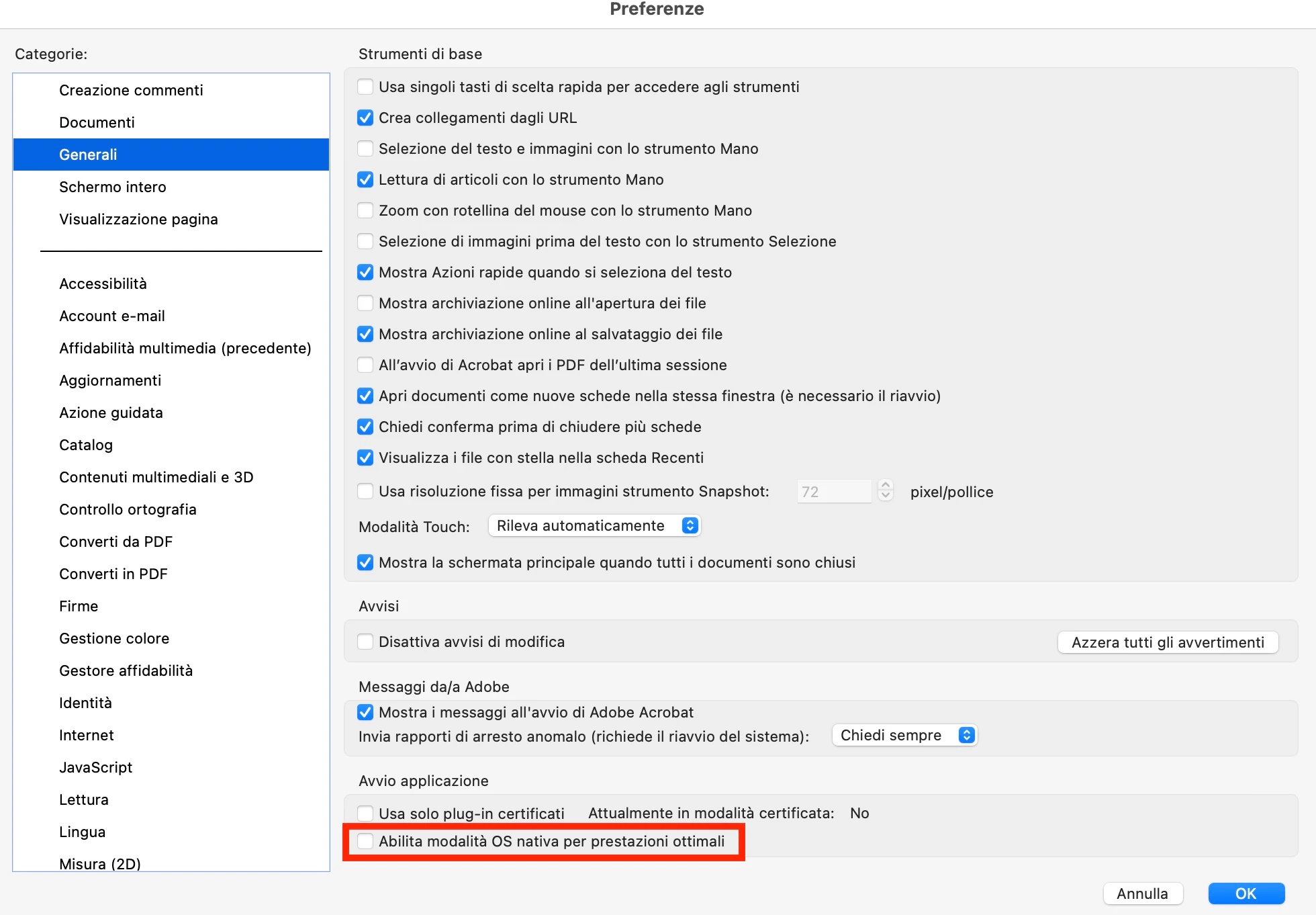

Acrobat Pro 23.0 on MacBook pro 15" i9 Monterey works fine.
I migrated my occount to MBP 16 M1Max with Ventura and I cannot use "combine file in a single PDF". It stops with a message "Impossible to convert file.png (or other format). Delete it and try" (I translate fron Italian).
Same files on MBP15 works fine (Acrobat convert all the files in a single PDF).
I think I solved it (I hope this can help someone):
On Acrobat Preferences - General - disable "Enable native OS mode for optimal performance".
Now it works fine!
Correct answer RobertoDG
Thanks Karl,
I hope I understand.
To solve the error on Acrobat version 2023.003.20201 on MBP16" M1 max with Ventura during the function "Combine files in a single PDF" (sometime il crashes, sometime appears the message "Impossible to convert file.png (or other format). Delete it and try", follow theese steps.
Go to Preferences - General - and disable "Enable native OS mode for optimal performance".
It works fine now!
See the attached file to disable the function (in IT language).
It works fine now!
