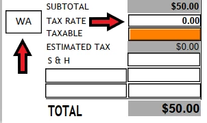

I've been piecing together a javascript that is supposed to add the state sales tax (in decimal format) to my text box named "Tax_Rate". The value that is entered in the box is based on the abbreviated state name entered into the "State" text box. I've tried using Switch and IF for the script and both had no errors. I can not get this script to run in my form though, what am I missing? Please help, I'm pulling my hair out!

glazed01Author
February 7, 2024
@Nesa Nurani the intent is to use the code in the Tax_Rate box to populate the tax based on the abbreviated state. Although, using it in the State_0 box makes more sense. The script you have above works when I use it in the State_0 text box, however, the tax rate shows as 0.00 for each state listed. Any suggestions?
Nesa Nurani
February 7, 2024
Please post the file with the script you tried.
