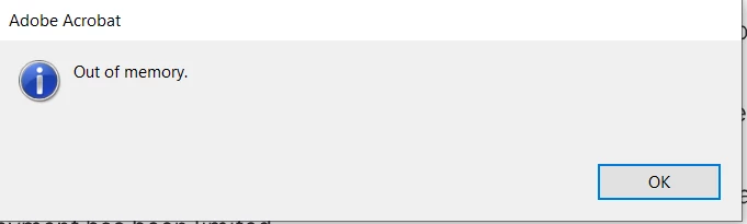

Error messages:

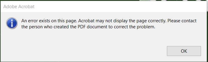

On start up both documents display this error message:
The original publisher is unknown and unknown software it was created with.
If you scroll up and down the document too fast. Document returns to normal on pressing OK.
Again, if you scroll up and down too fast. Document returns to normal on pressing OK.

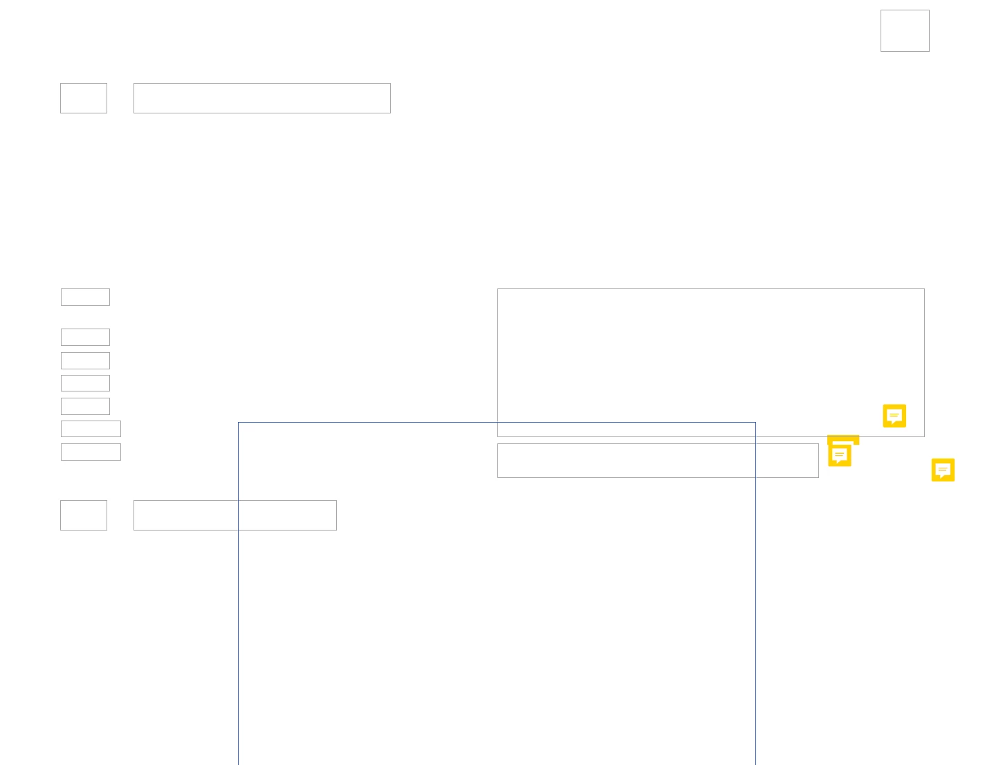

When things start going wrong, either a black page or this, white with artifacts.

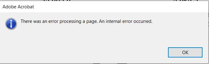

Multiple “Error processing page” errors pop up.

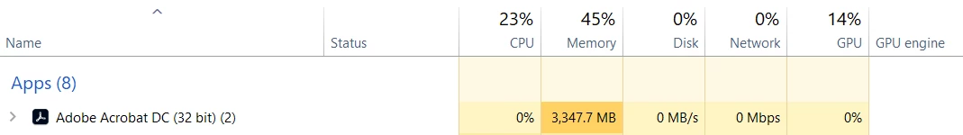

System resources remain nominal. No memory leak detected.
