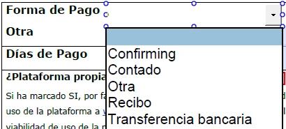

So I have a Dropdown that is required for my form. With 6 options, one of them is a blank option that is the Default one, so User HAS to pick one. Is like this:
I want this dropDown to only be required if that "blank" option is selected. As of now, it still remains with the red outline whatever you choose. Name of this one is Dropdown1.
Moreover, if the person chooses "Otra" a Texbox called "Forma de Pago Otra" should be set to required. Once you written something, it should stop being required.

The red border indicates that the field is required, not that it's missing a value. To do what you asked for would require using a custom-made script to change the field's border color based on the value, and you would have to turn off the built-in fields highlighting feature for it to work properly. I'm not sure that's a good idea...

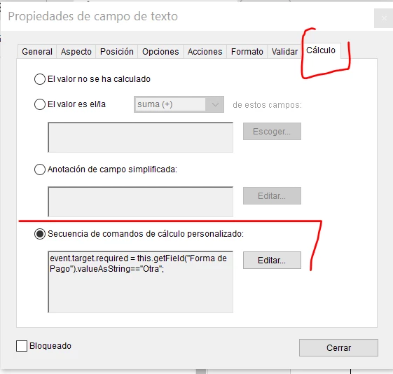

As for the conditionally required text field, you can use something like this as its custom Calculation script:
event.target.required = this.getField("Forma de Pago").valueAsString=="Otra";

hey @try67 ty for the reply! Oh 😕😕 yeah... seems more complicated than needed. But, is there way to set the required value to "false" if something has been written on the TextBox? As of now, I write anything, its still required.
As for the calculated thing, where do I set that? I tried here in the properties of the textBox i want to be required should "Otra" be chosen. Sorry for Spanish 😞

Yes, you can do that. For example, you can use this code as the custom calculation script of the drop-down:
event.target.required = (event.value==event.target.defaultValue);
The same code can also be used for text fields.
And the place where you placed the code is correct. Is it not working?
