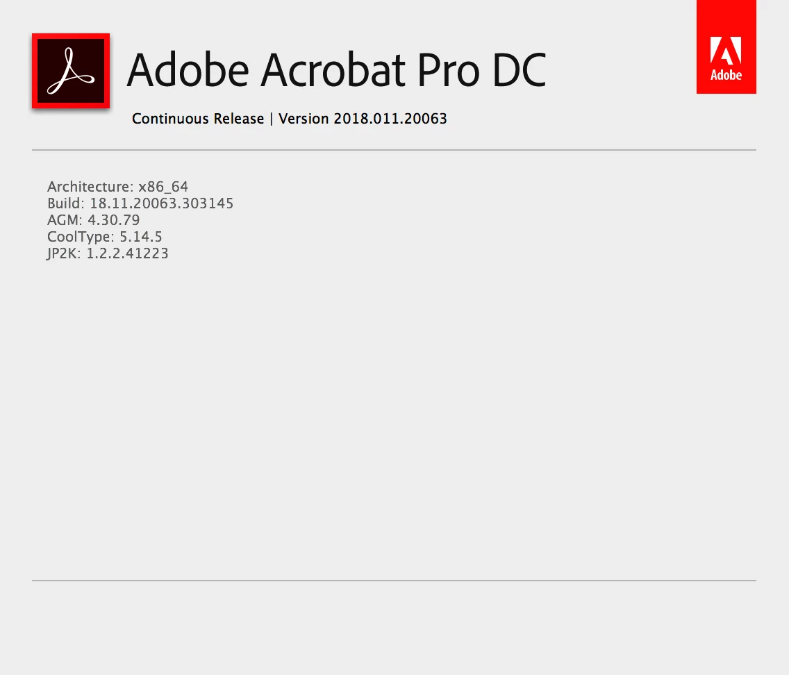

I know this is an old thread but I am having the same issue when creating a PDF from MSOffice document on Mac OSX - the hyperlinks are not preserved.
MacOSX version:  High Sierra 10.13.6
Microsoft Office version:  Office 365 16.17 (180909)
Adobe version (see below):
No problems on a Windows laptop with the Save As... process.
