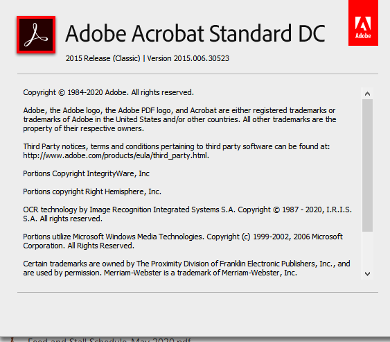

I tried the accessibility checker but think my version of DC does not have it like that. Included screen shot of my version of Acrobat.

Since you mentioned about having two different  Acrobat Pro  products installed in the same machine, I am wondering if this is what is creating the the inconsistent color rendering issue.

- I am not running 2 versions of Acrobat, and not running Pro. I am running DC (which I think is the same as 2015) and have already fully uninstalled and reinstalled the product. And then checked for updates. I included version in this thread earlier.

This is a rather long discussion and I may have missed some of it. You seem to be using only old and obsolete software versions, so far as I can see. Here is a recent version of Acrobat Reader:
