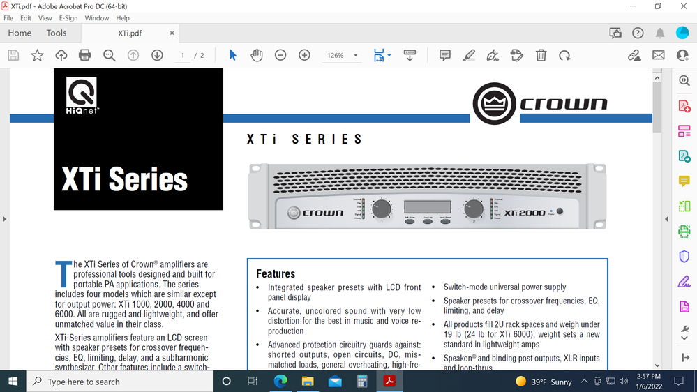

Can someone please tell me how to change the navigation pane settings for a specific PDF file.
For example, I have some PDF's that display a navigation pane on the left when I open them. I also have some PDF's that do not display a navigation pane on the left when I open them.
I need to make them all the same way by either removing the navigation pane to some or by adding a navigation to some. Please tell me how to do this.
Please see pictures below. Thank you,

Change your document properties and view. Then try saving and securing the PDF.

I assume you want control over the different collapsed views--one with icons and one without. Is that correct?
It might be handled by a JavaScript but I can't get a PDF to stay without any icons showing up upon re-opening.

Yes, that is corect.
How do I remove the icons from a PDF and save it so they dont appear when I open it?
How do I add the icons from a PDF and save it so they do appear when I open it?

I figured it out. All you need to do is either collape or expand the navigation pane to a PDF and check the box "restore last view setting when reopening documents" in the prefereFix.pngnces.

Many of the navigation icons appear only if they are relevant. The Standards icon will always appear when the PDF conforms to one of the special standards like PDF/A, PDF/X.
Jan 09, 2022 Jan 09, 2022
To my knowledge, the navigation panes are not controllable by JavaScript.
Just curious, what about the icons is causing a problem?

Yes, the navigation pane can be controlled with JavaScript, although it is not documented, and not all setting are available.
So to do this you need to experiment with the "doc.viewState" property to see what works.
First, open a PDF and setup the navigation pane.
Then run this code in the cosole window:
( you'll find a tutoial here on the console window - https://www.pdfscripting.com/public/Free_Videos.cfm#JSIntro)
this.veiwState.toSource();
If the pages panel is open you'll see something like this:
({ocgStates:null, overViewMode:2, overViewPos:240, overViewX:0, overViewY:0, pageViewLayoutMode:1, pageViewPageNum:0, pageViewX:-161, pageViewY:0, pageViewZoom:3.231109619140625, pageViewZoomType:1})
overViewMode and overViewPos indicate the navigation panel displayed and the width of the panel.
Put this code in a document script to setup the viewState when the document is opened.
this.viewState = {overViewMode:2, overViewPos:240};
