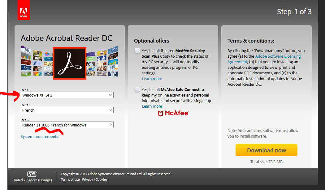

Acrobat seams to be quite sticky with it's versions. The only trick I'm aware of to ask for a prior version is to ask the download for an older OS:
This however will make your installation vulnerable.
