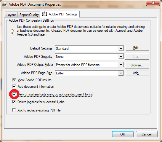

I was able to resolve it by changing a one of the Adobe PDF printer settings.  When you are in the print dialog, and you have selected the appropriate PDF printer, select "Properties."  In the dialog box, there should be a tab titled "Adobe PDF Settings," and it should look like the below image.  You need to un-check "Rely on system fonts only; do not use document fonts."  I'm going to bet you created this document using XP or Vista, then upgraded to Windows 7.  I'll go further to guess the Cambria font somehow gets changed between XP/Vista and Win7.  In any case, I had a document I created using Word 2007 in Vista that I could print o a PDF.  Then, after upgrading to the RC version of Win7, I couldn't print the document to a PDF anymore.  Un-checking the box I mentioned here seems to fix the issue.  I'll reply back if I ever find a situation where this "fix" does not work.

Great, this Workaround works for me! Thx
At least this solves all my PDF related problems with Office 2007 and W7.

Great fix... thanks!!

Thanks.  I had the exact same problem after upgrading my Vista to Windows 7 and it was driving me nuts!  I had changed so many Distiller settings that I couldn't keep things straight. I could make PDFs from Excel and PowerPoint - just not Word.  I hope things 'straighten out' in Acrobat 9 - I'd hate to have this 'workaround' be the 'long-term' solution.

I know this is a couple of months old, but I was having the same issue. I also did the fix listed above, but went in the settings and manually selected to ALWAYS embed Cambria fonts. I am using Windows 7 with Acrobat Pro 8. Under devices and printers I went to the Adobe PDF printer, right clicked and selected Printer Properties. Then I clicked Preferences. Under default settings I chose to Edit (This is under Adobe PDF Settings). I then chose font and chose to Always Embed cambria fonts by highlighting them and clicking Add. I also saved these settings to use just in case I ever forgot how to do this fix. Hope that helps anyone else that might have still been frustrated. I can now right click on my Word docs and choose to convert again. Woohoo!
