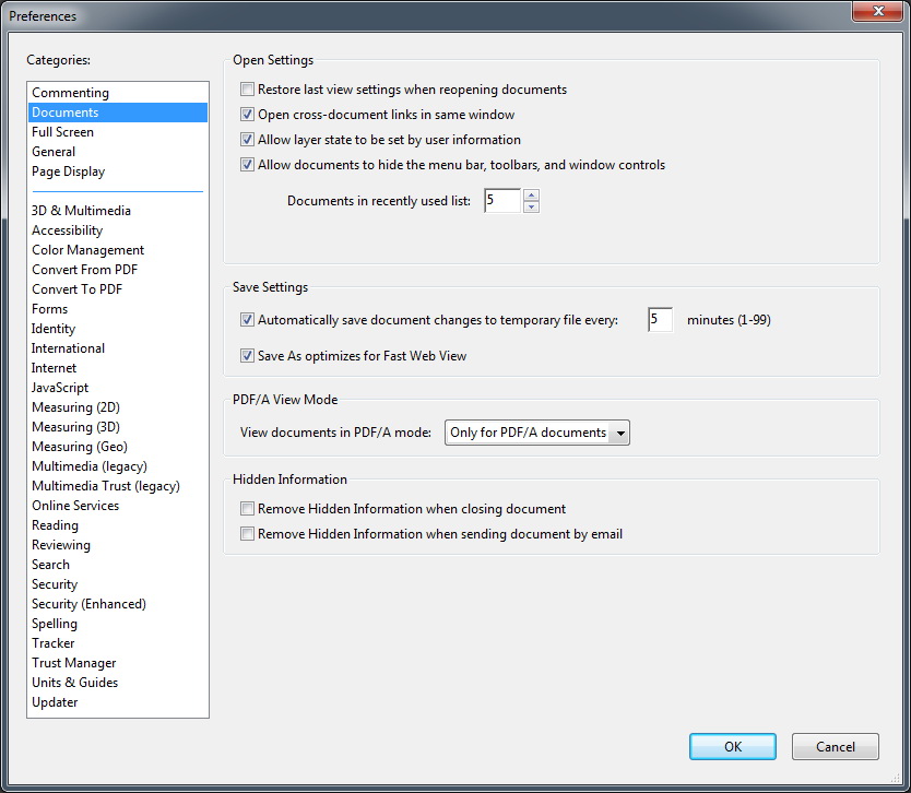

If the file was somehow converted to PDF/A, I'm not certain how. Here's my scanner's "Configure Presets" page:
And going through the preferences settings didn't yield much to go on either - The only PDF/A setting I found was on this page and it seems appropriate. I did try toggling it, but it made no difference.

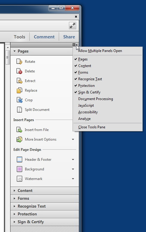

Dave Merchant wrote:
"Set Page Boxes" is on the Tools Pane / Print Production Panel, and opens the dialog directly with blank fields. Print Production in Acrobat Pro is a hidden panel by default, you must show it using the dropdown menu on the Tools Pane header bar.
I can get to "Set Page Boxes" from the Tools | Pages | Crop menu, but then all the size options are grayed out. I can't find "Print Production."
Looking at my installation, under Tools are "Pages", "Content", "Forms", "Recognize Text", "Protection" and "Sign & Certify." Hidden by default are an additional "Document Processing", "JavaScript", "Accessibility" and "Analyze", and nothing sticks out as an alternative way to get to "Set Page Boxes."
How do I get to the "Print Production" panel?
