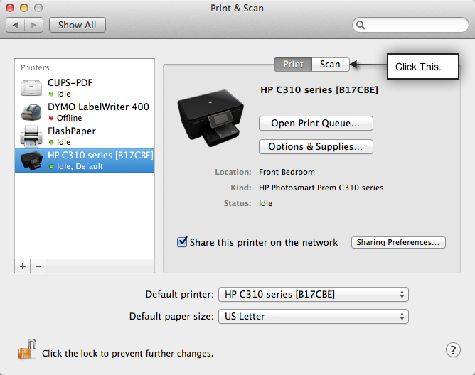

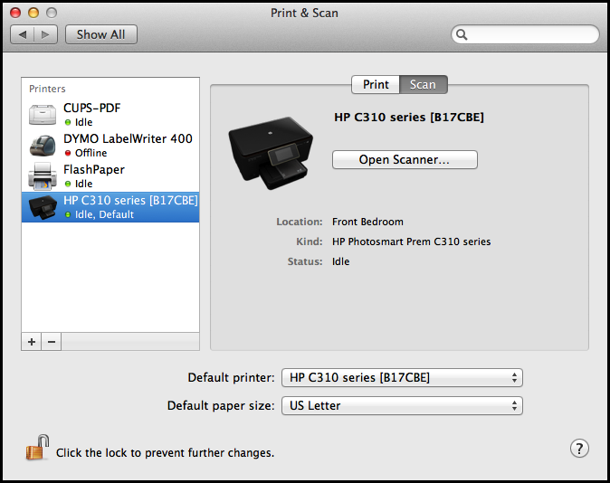

I use a C310 ePrinter from HP and it works with OSX7 and 8.
And it works just fine with Acrobat.
In order to make it show up when setting up and use:
Works Great. HP already use Proper Driver. Its just setting the Print Scan Control Panel first so it is recognized as a Scanner.

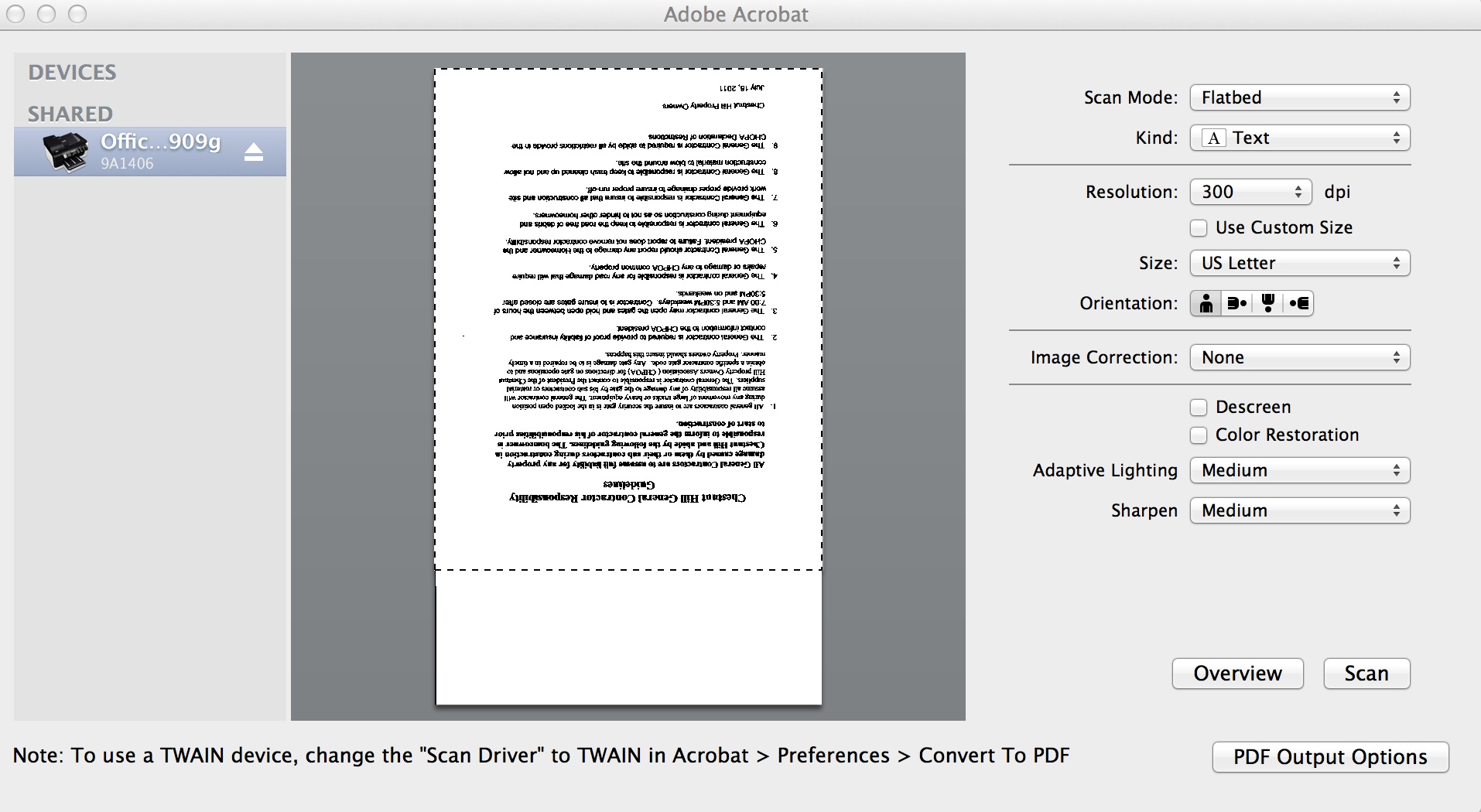

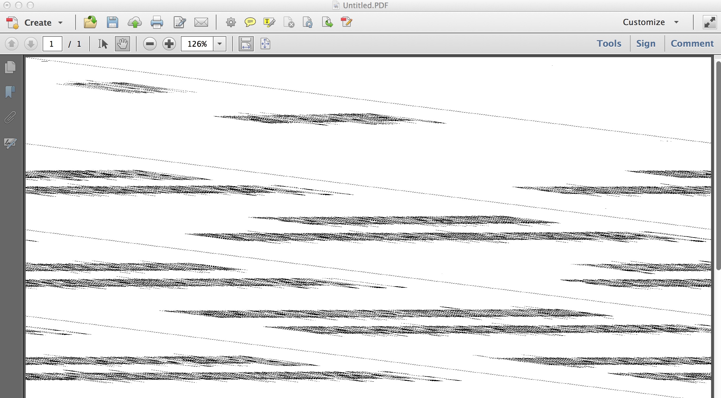

Although changing to 'imagecapture' finally allowed Acrobat Pro to recognized my HP Officejet Pro 8500 printer, the final scanned image is distorted and blurry.
The Overview Scan looks normal (see image below).
But once the image is scanned, this is what it looks like:
This is the same for any document I try to scan. I can go back to Mac Os x Preview app and the documents scan properly. Is anyone else having this issue?
