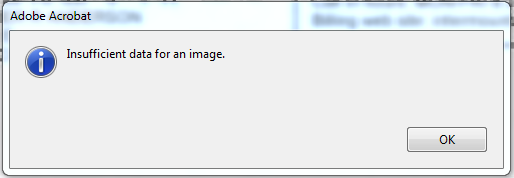

Thanks for your note, which sounds correct to me. Further checking shows me that the problem I am having is not uniform across all PDF files. Some open correctly, others fail. Further, almost any PDF I have created by scanning from a Kodak i2600 scanner using native drivers (i.e. Kodak driver set) and Nuance PaperPort Pro 14 are having this problem. So there might be an embedded JPEG issue going on here, failure to fully load maybe.
I am new to this forum and unfamiliar with navigation to other threads. If you have run across a solution to the problem or know a way for me to try reinstalling a JPEG2000 security fix, please let me know. Otherwise, I've just reported it as a 'bug' although I have no idea if it's something that's gone wrong on my own workstation or if it's a problem in the update itself.
I can upload error message image (see below) but am not sure how to upload a sample PDF.

I can confirm that this is a JPEG2000 image.
This is seeming more and more likely to be a security fix, but let me make it clear what I mean.
I think an update to Acrobat 9 and 10 includes extra checks to JPEG 2000 data in PDF files. Perhaps the earlier version quiely ignored a problem, or perhaps there is a bug in the new checks.
There are signs that this is for some people related to high resolution access to the JPEG 2000 e.g. zooming or TIFF export. This is not too hard to explain, as JPEG 2000 files might contain multiple images at different resolutions.
Speculation: perhaps the older software found bad high resolution images, and ignored them using the low resolution instead. But perhaps the new software doesn't tolerate this at all.
We'd really have to hear from someone at Adobe or a JPEG 2000 format expert to be sure.
Copy link to clipboard
Copied
I tried a work around. I opened the file in AA8 and ran the PDF Optimizer on it. This changed the graphic encoding to JPeg from what had been JPeg2000. The resultant file opened fine in Acrobat 9.5.2.

Thanks very much for the reference, Bernd. As the blog suggested and as Bill suggested, saving the PDF again in PDF Optimizer works to achieve a correct display and avoid the error. The zoom reduce and re-size to fit page did not have a positive effect for me, however. It appears that this is now a known problem at Adobe, and they are working on it. Thank you all again for your help.
