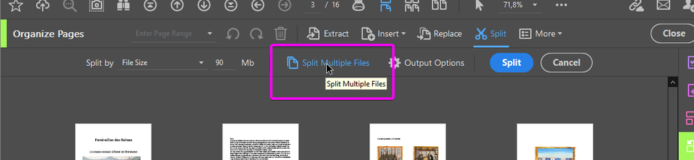

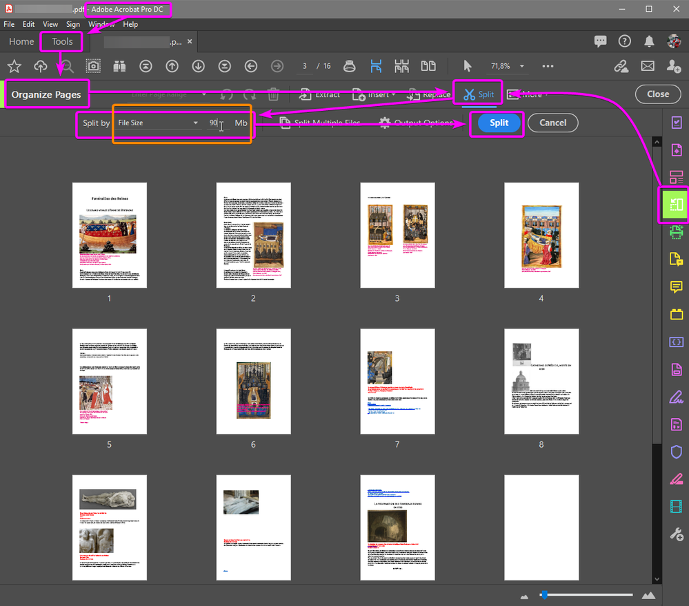

You don't need to handle them one by one.
What is wrong with the "Organize Pages" tool?
With the Organize Pages tool you can do more than just one PDF into smaller files using the "Split Multiple Files" feature. This feature also allows you to split the files by number of pages, file size, and top level bookmarks.

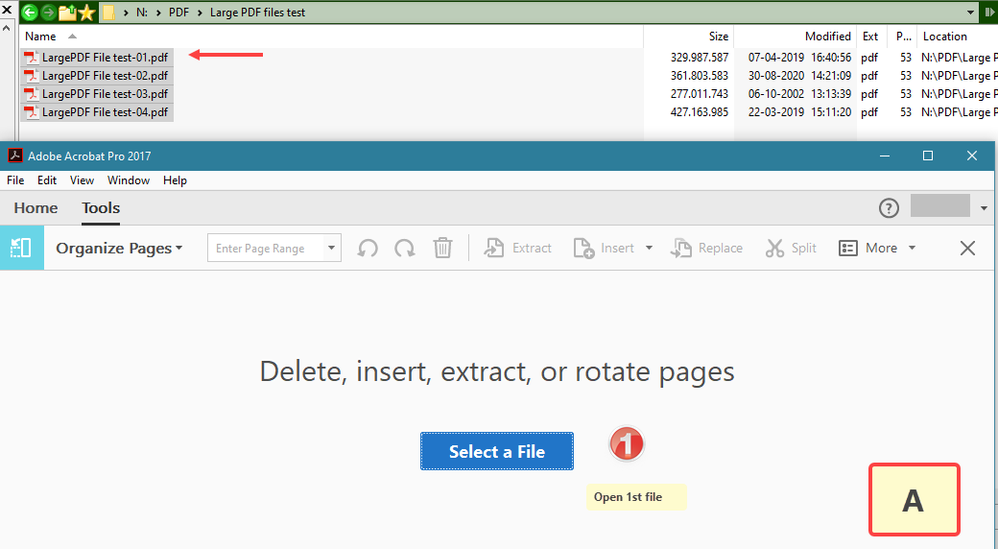

Just gave it a try, see below.
Next the below steps, on the right the results.
Note that 50MB is the maximum, that is to say within Acrobat Pro 2017, maybe in DC the max is set higher.
Anyway, many thanks again!
