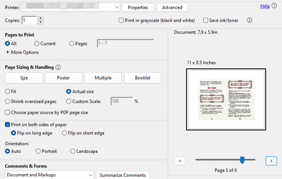

A lot of boardgame publishers provide PDFs of their instruction manuals.  These are rarely a standard page size, and often a standard size won't fit in the box. The white boarders of a full-size, printed manual can be cut off, but then it either needs stapled in the top corner (like a report) or stapled on an edge.  Both of those are ugly options.
Printing them as a booklet could be a solution.  Booklets of full, letter size documents come out really nice. Unfortunately, Acrobat centers each of the smaller-than-letter pages inside a white boarder instead of connecting the printed areas in the center of the paper and bordering just the outsides. Thus, the booklet doesn't print in a way to make a nice booklet.  Even if I cut down the outer edges, there is a weird-looking white "spine" (i.e. the red box in the image).
How can I "mush" the pages together so that when printed, it will make a nice booklet?  So it prints like this:
Thanks!

The pages are 3.94 x 5.83 inches.  If I print them "actual size" I get this:
and if I want to produce a booklet using the full size of the pages, I get the something like the image in my OP (where I added the red rectangle). I modified that picture to show what I want to print.

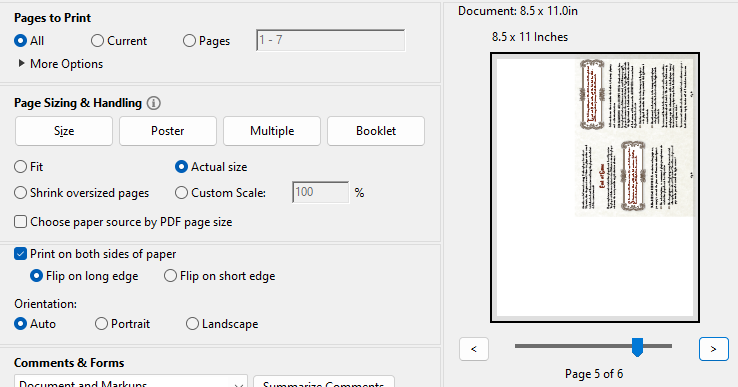

  2. When I did it with my example, the preview would show the pages filling the letter size sheet, but when the saved document was opened, it was "broken".  For example:
    results in the following document:
    On the one hand, the pages are together, and having them in a corner is useful for trimming.  On the other hand, they aren't any larger, and not all the pages line up (which I can't really show here).  Maybe this is a bug in Acrobat?

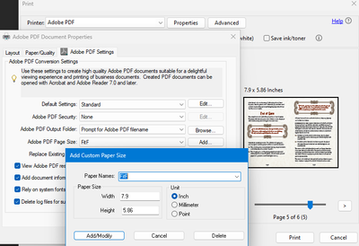

The solution is to "print" a booklet to the Adobe PDF virtual printer but create and use a custom paper size.  Like this:
Then, print the resulting PDF to regular paper at whatever scale suits you.

Thank you so much for posting this solution; it solved a problem I've been fighting with for days. I have no idea how Adobe could think this is an acceptable user experience.
