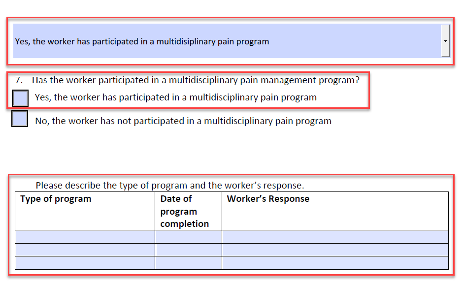

I am helping develop a form with an existing dropdown (yes/no) question where depending on if 'yes' or 'no' is selected, subsequent questions are presented to the user based on their selection.
I've been asked if it's possible to do this with check boxes (instead of a dropdown). Given the question is mutually exclusive (must be either 'yes' or 'no'), I thought radio buttons might make more sense here - however, when I go into the radio button field properties, I noted there is no 'calculate' tab (as that might appear when using the dropdown field for instance). And with no calculate tab, I am unable to identify if/where any javascript calculation would go (if at all possible?).
So I guess my question is if it's possible to convert the existing javascript (used in the dropdown) to either radio buttons or check boxes (the subsequent form follow up questions remain the same, it's just an 'aesthetic' change requested by the team who use/manage the form.
Hopefully the above makes sense. Happy to clarify or provide further details/screens if required.

Hi Nesa, many thanks for your reply and sorry for the delay getting back to you - have been offline from work for a few days since I posted my original query.
Thanks for the suggestion on the checkboxes, that may be the better option here from a user POV.
Have attached the PDF page and some screenshots of the 'yes' and 'no' state when selected in the dropdown list - these javascripts would ideally then need to be converted to be used on the 2 new checkboxes below the dropdown.
Bizarrely, when I click on the dropdown (the javascript works) - however, when I visit the calculate tab, the javascript is not show in the custom calculation section (but is still recorded in the javascript editor) - have come across this a few times on my various forms so I'm not sure if that may suggest an issue with my Adobe Acrobat DC perhaps...Hopefully you will be able to see the Javascript calculation on your end.
In any case, this was the javascript used for the dropdown I believe

Many thanks Nesa, good pick up - the last round of changes were made before Christmas so I can't recall how or why the thinking of putting the formula into such a small text box ( a colleague who was familiar with Javascript helped me at the time). Perhaps your earlier reply and the 'hidden text field' was the reason?
I've managed to make the checkboxes mutually exclusive and renamed them 'MultiDisciplinaryPMPCB'. 🙂
Though now the JavaScript I tried to repurpose from that text field doesn't seem to be working as I'd hoped. Not sure if you might be able to see why?

YES:
var e = this.getField("MultiDisciplinaryPMPCB");
if ((e.value == 1) ) {
this.getField("Header2").display = display.hidden;
this.getField("Header2Ans").display = display.hidden;
this.getField("Button1").display = display.hidden;
this.getField("TypeOfProgram1").display = display.visible;
this.getField("TypeOfProgram2").display = display.visible;
this.getField("TypeOfProgram3").display = display.visible;
this.getField("DateOfProgCompletion1").display = display.visible;
this.getField("DateOfProgCompletion2").display = display.visible;
this.getField("DateOfProgCompletion3").display = display.visible;
this.getField("MDPMWorkersResponseRow1").display = display.visible;
this.getField("MDPMWorkersResponseRow2").display = display.visible;
this.getField("MDPMWorkersResponseRow3").display = display.visible;
else {
this.getField("Header2").display = display.visible;
this.getField("Header2Ans").display = display.visible;
this.getField("Button1").display = display.visible;
this.getField("TypeOfProgram1").display = display.hidden;
this.getField("TypeOfProgram2").display = display.hidden;
this.getField("TypeOfProgram3").display = display.hidden;
this.getField("DateOfProgCompletion1").display = display.hidden;
this.getField("DateOfProgCompletion2").display = display.hidden;
this.getField("DateOfProgCompletion3").display = display.hidden;
this.getField("MDPMWorkersResponseRow1").display = display.hidden;
this.getField("MDPMWorkersResponseRow2").display = display.hidden;
this.getField("MDPMWorkersResponseRow3").display = display.hidden;
NO:
if ((e.value == 0) ) {
else {
Feb 21, 2023 Feb 21, 2023
Well, the script will work, but you are showing/hiding same fields in both script.
Perhaps you want to replace fields from 'else' and 'if' in 'NO' field script?
