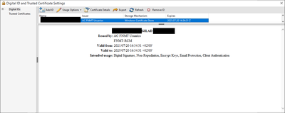

Jan 23, 2024 Jan 23, 2024
quick question can we use certificates for signing FNMT on the free version in Spain?
Yes.
