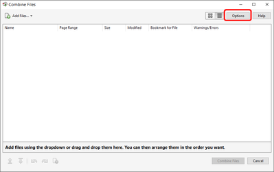

You've created a Portfolio. You can change it back via the Option button in the Combine Files dialog:
Then set File Type as "Single PDF":
Note that you won't be able to combine files in this way if one of them is digitally signed, certified, protected or was created using LiveCycle Designer, though.
