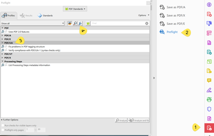

To run Acrobat's Preflight:
  1. Locate Acrobat's Preflight tool panel.
  2. Open the panel. Ensure that PDF Standards is selected from the drop down menu at the top.
  3. Select PDF/UA, select Fix problems in PDF tagging structure, and then the Analyze and Fix button in the lower right.
4. If you want more detailed control over what it analyzes and fixes, then select the blue wrench in the upper right (yellow #4) and it will show an expanded view of the minute details of checking PDFs; however, without training, these might be confusing. 
