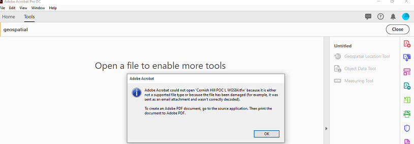

If it is , I tried converting the file to a format that can be accepted by Adobe, such as, the ones shown in the bottom right corner of this slide but the second slide show what I get in return
I normally use IrfanView as my main application to convert files of any type. It is supposed to be a very robust platform to this type of file conversions. So I went ahead and tried to import in Adobe.
When trying to import to Adobe the same message; that is two different applications displaying the same information about this particular file.
I also went to the Microsoft App store and they don't have a program available there  that would , could or should  associate this type of file to work with it.
I am thinking that, maybe, when the file was georeferenced from the original software it needed to be saved as a shape file in another file format rather than tfw? (ahpe file in DFX format, then convert it to JPEG2000 or TIFF. )
Based of  what I am reading when the shape file is exported into JPEG2000 or TIFF it is supposed to retain all of the geospatial data during export/import procedures into the PDF editor.
As you can see below, I was able to import as layers the first two files that you provided above
But when trying to import this "tfw" file into pdf no luck and I am not able to get coordinates.
