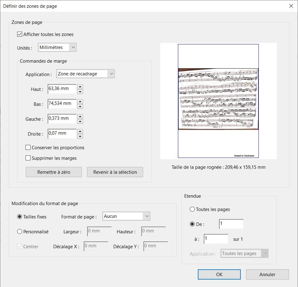

I have a PDF file with inside some pages that have not the same size. I would like to have all pages at the same dimensions. So I gone inside "Modify / Crop" and selected a rectangle on the first page then double click on it to have the crop window. In the crop window I selected "Cropping area" extended to "all pages" and click OK but nothing happens : all the pages are not cropped to the same size (I am always with some pages that have not the same dimensions). Have you a solution ?

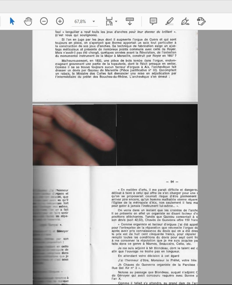

In this screenshot I have surrounded in red my problem.
The problem is on the screen : between two pages scanned I have a difference (the alignment is not OK).
How to have on the screen a perfect alignment between pages with acrobat Pro DC ?
December 27, 2019
You didn't answer my question about what size the pages actually were, but I can see the problem. The Crop Pages tool - if you look at the dialog - translates your dragged box into a margin to remove, then removes the same margin from each page. You need to use Change Page Size - but you'll find that it won't reduce page sizes! Here is the trick.
