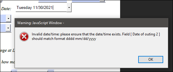

I am working on a form inserting the date.  I was hoping to add the day of the week with the date format.  I checked on the format and went to the custom selection and inserted dddd mm/dd/yyyy.  The hurdle I am trying to get past is, when I go to select a date, I receive a javascript error message telling me that it is the incorrect format that I should use dddd mm/dd/yyyy.  I am javascipt challenged, LOL.  Am I missing a setting somewhere or something? Any guidance or assistance would be appreciated.  I am thinking its a simple issue.

Thanks for the info, I tried that and I still received the date error.  One trick I did try was to put the format as
mm/dd/yyyy  dddd and it seems to work.
dddd mm\/dd\/yyyy is what I tried
Am I missing something?

Such a strange bug.
It correctly displays the date during the alert and when you click OK it disappears (back slashes don't change anything).

Yeah I know, I did place the dddd for the day of the week at the end of the format and it works perfectly and there isnt an error message.  Weird.

I recommend you use two fields. One with just the date, and another with a calculation script to show the day of week for that selected day.
