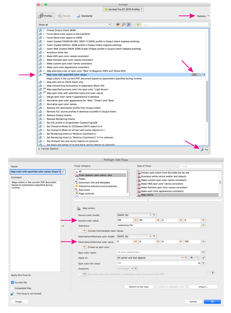

Your suggestion is a good one. If you combine it with a preflight profile to move all images to a layer, then delete that named layer (two custom preflights combined into an action), it might work well. Another option that might work with the original scanned image is to run two custom preflights, one to map all whites to rich black* and another to map all blacks to white (also combined into an action). *the choice of rich black should protect the new color from the subsequent black to white mapping.
The attached screen shot shows a preflight profile mapping a blue color to black.
