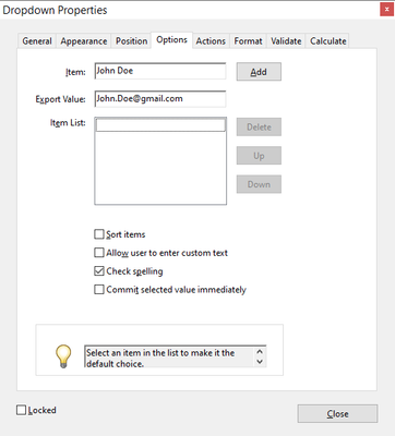

See: https://acrobatusers.com/tutorials/dynamically-setting-submit-e-mail-address
All you need to do in addition to what's described in the article is to place the email address of each person as the export value of their item in the drop-down, so the name is the display value, and the email the export value, like this:
