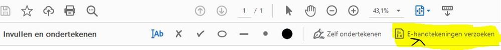

Hi Guys. Request e-signature option missing from adobe acrobat dc pro 64 bit. But it is available in old pc when logged in with the same licensed account where 32 bit adobe acrobat has been installed. Tried almost every possible fix but unable to see the request e-signature option in 64 bit adobe acrobat. Please help.

Hi Amal Greetings. Following troubleshootings were done. Still Request
signature missing. Please advise me if you have any other fix.
Findings:
Ø User when logs into the previously used hp laptop and access acrobat-
can use the Request signature
Ø Old laptop has 32-bit version Adobe Acrobat DC
Ø When a user started using a newly imaged dell laptop and tried accessing
adobe – request signature option disappeared.
Ø Uninstalled and reinstalled both adobe acrobat dc and creative cloud and
tested- no options available
Ø Go to Help > Check for Updates.
Ø Also, go to View > Show/Hide > Navigation Panes > Signatures and see if
this brings up the signatures in the PDF file- no options available
Ø Tried installations from the admin login and tested-no options available
Ø Compared the acrobat settings with the user colleague who has options
available and tested- no options available
Ø User has the Request signature options from document cloud
https://acrobat.adobe.com/link/home/
Ø User has the latest version of acrobat 22.1.20085 installed.
*Ø **Restore the Acrobat Preferences folder (Windows)- still no options
available*
*Ø **changed the language to English- no options available*
Ø *Used *Acrobat cleaner tool
https://www.adobe.com/devnet-docs/acrobatetk/tools/Labs/cleaner.html,
reboot the computer, and reinstall the application using the link
https://helpx.adobe.com/acrobat/kb/acrobat-dc-downloads.html and check if
that works- still no options available.
Ø Managed to install the 32-bit adobe similar to old pc and tested- still
ØRemoved and reassigned the license and checked-still no options available
Thanks, Bishal
