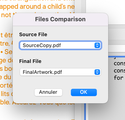

Here is what I did at the moment. The final layout is still missing but before do it, could you check this script on a few file.
You must choose 2 files from the open files:
 Then after clicking OK you will get the result in the console window.
 The script is a bit more complicated as I thougth because of what I try to explain in my previous answer...
Here is the script you can run from the console window or an action wizard:
