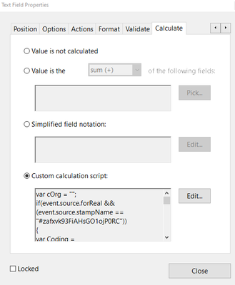

I have a script that creates a dialog box and stores the users responses in variables.  I now need to get that stored information to display in a text field on a dyanimic stamp. I can get the information to the variables, but when I try and reference the variable in the text field, I get nothing. Any help is appreciated. All the coding is entered into the first text field (bBx01) in the Text Field Properties, Calculate, Custom calculation script:
Attached is the script with example pictures.

Down where the dialog values are being printed to the console,
Change the line
console.println("Bx01:" + Coding.bBx01)
To:
this.getField("bBx01").value  =  Coding.bBx01;
Follow the same pattern for each line. i.e. Aquire the field object and set it's value to the corresponding dialog object member variable.

Thank you so much on my first issue. Another problem. I need to have the coding to allow this to run ONLY if this stamp name is chosen.  Where would I put that in all this coding. It keeps throwing an exception in the console whereever I think it should go.  Attached is the script for that area of coding. Why am I getting an Exception in line 185 of function top_level, script Field:Calculate.  Also, is there a way 'on Cancel' to have the stamp remove itself from the page instead of me selecting it and then deleting? I figured out how to make the fields show nothing on cancel.

Line #1 contains the code for qualifying when the stamp code is run:
if(event.source.forReal && (event.source.stampName == "#Tg8BLUAxXrBBTqV2OQRX9A"))
As long as the stamp name is correct this if will only allow the code to run when the specified stamp is selected for placement. If the stamp name is wrong, the code won't run ever.
There is no line #185 in the code you posted. In fact there are only 118 lines total.
Given the two things you've mentioned, popup displaying more than once and the error on a line that doesn't exist in the posted code,  it sounds like it is some other stamp script is responsible. Are there any other dynamic stamps installed?

Here is the current script. Sorry about that. I do have other dynamic stamps, but all have the restriction on them.
May 20, 2021 May 20, 2021
There's an opening curly brace missing from the end of line #185.
