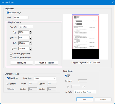

Community Beginner ,
Nov 27, 2024 Nov 27, 2024
This was irritating, why is this not an option?
A couple of options:
Quick, Dirty & BASIC (does not work for forms);
Make sure all text is centered in the top 8½x11 area
Print to Adobe PDF…Manually select Orientation (not Auto) and Actual for Page Size…In Page Setup,  change Print Size to Letter
Print and save.
{This just gives you a basic PDF that is Letter size}
To actually Crop Pages (this is not intuitive):
Make sure all pages are lined up and all text is within your top 8½x11 space
Go to the Organize Pages tools
Select More…Set Page Boxes
In the Page Boxes action window;
Uncheck Constrain Proportions and Remove White Margins
Adjust the CropBox measurements around the widest amount of text on the page (Make sure your Cropped page size is = or LESS than 8½x11)
Set Page Range to ALL
Hit OK
Save As a different file and see if it works for your needs.
{This does NOT change scanned images or content.  This does not actually crop the images. This does not change the original document size.  But it should give you a Letter size PDF to print.}
Print and save.
Hit OK

New Here ,
Jul 10, 2025 Jul 10, 2025
To change the page size in Acrobat, go to "Print Production" > "Set Page Boxes," where you can adjust the page size from Legal to Letter without resizing the content.
New Here ,
Jul 11, 2025 Jul 11, 2025
Yup, I found that, and legal to letter works (anything "smaller" works). However, I cannot go from letter to A4. The A4 option is grayed out. I assume because A4 is narrower, but longer.  I create the document (in Framemaker) with a text window that fits in the margins for BOTH Letter and A4 (it leaves a little extra white space on the side of the letter format, and some extra white space on the bottom of the A4 format.  Then, I fill 160+ pages of text. I create the PDF at letter size. Now, someone in Europe wants the document in A4 format. So, I want to just change the paper size of the original PDF file. That way, all the page numbers stay the same so it's easy to share references and talk about the content.
The only way I can do this is with the PRINT option - but that strips out all the hot links and the Bookmarks.
